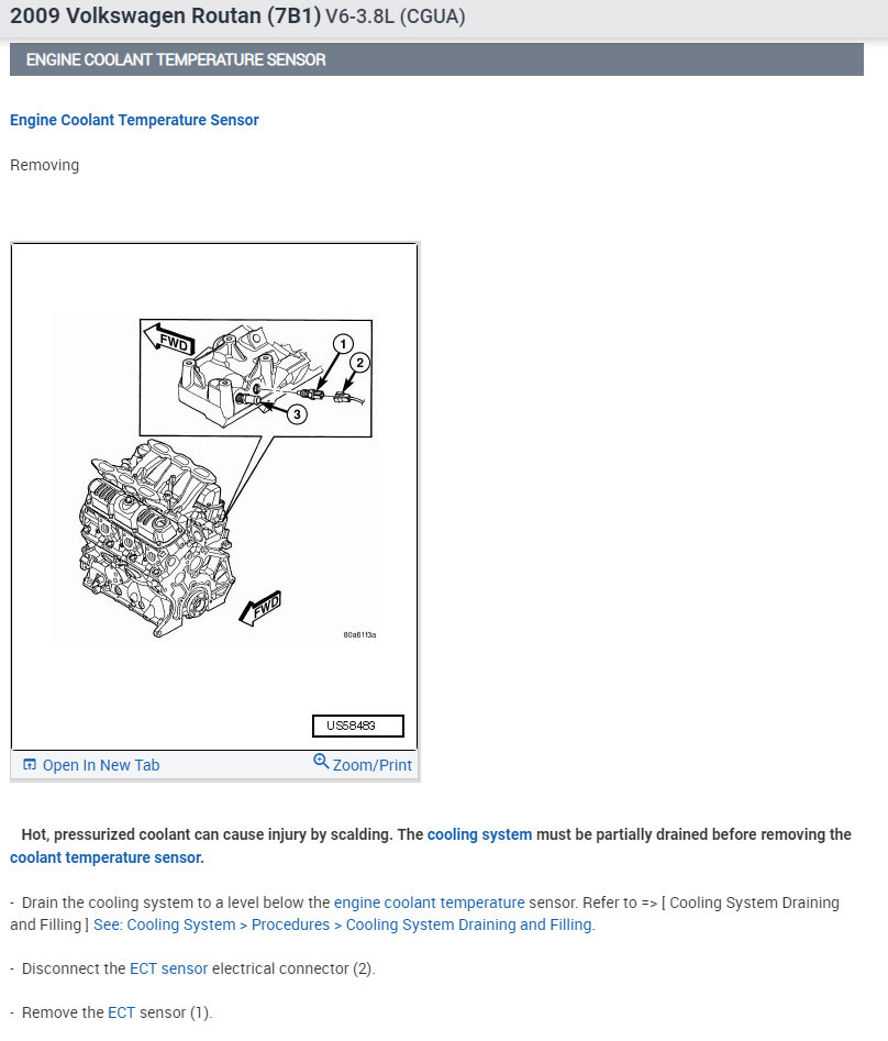

Where is the ECT Sensor located?
2009 VOLKSWAGEN ROUTAN
165,000 MILES • 3.6L • 2WD • AUTOMATIC
AUTOFRAN
I have been trying to locate the ECT sensor, no luck (or I just don't know where to look.
I would appreciate it if you could help! Thanks so much.
Aug 1, 2022 at 3:13 PM
SQM
  • CAR REPAIR CONTRIBUTOR
  • 6,383 POSTS
Note, that the 2009 Routan had a 3.8L V6, not a 3.6L.

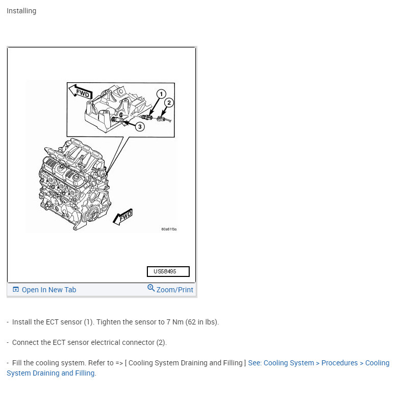

The coolant temperature sensor (ECT) is located on the back side of the engine below the intake manifold.
https://www.2carpros.com/articles/symptoms-of-a-bad-coolant-temperature-sensor
I have attached diagrams below for your reference.
Let me know of any questions.
