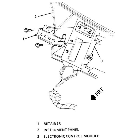

Can I replace my ECM with a used one without having to reprogram it?
May 22, 2019 at 10:12 PM
  • CAR REPAIR CONTRIBUTOR
Good morning,
Yes, the OBD1 system can be changed from one to another. You will need the exact number on the ECM and the prom inside will need to be changed as it contains all the info for your truck.
