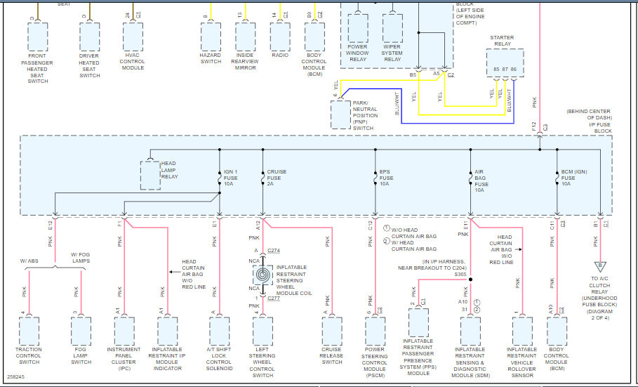

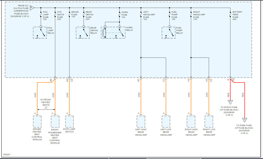

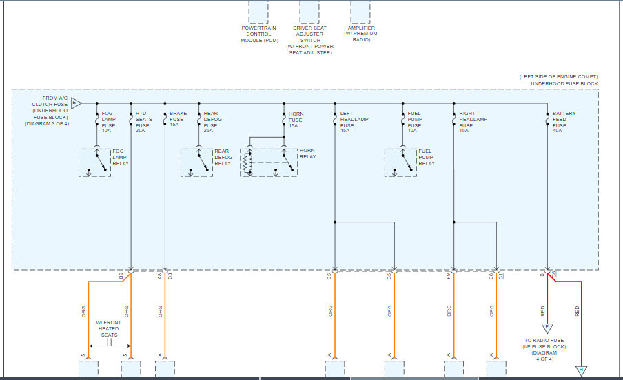

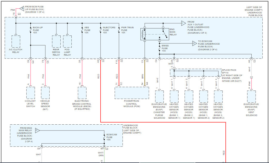

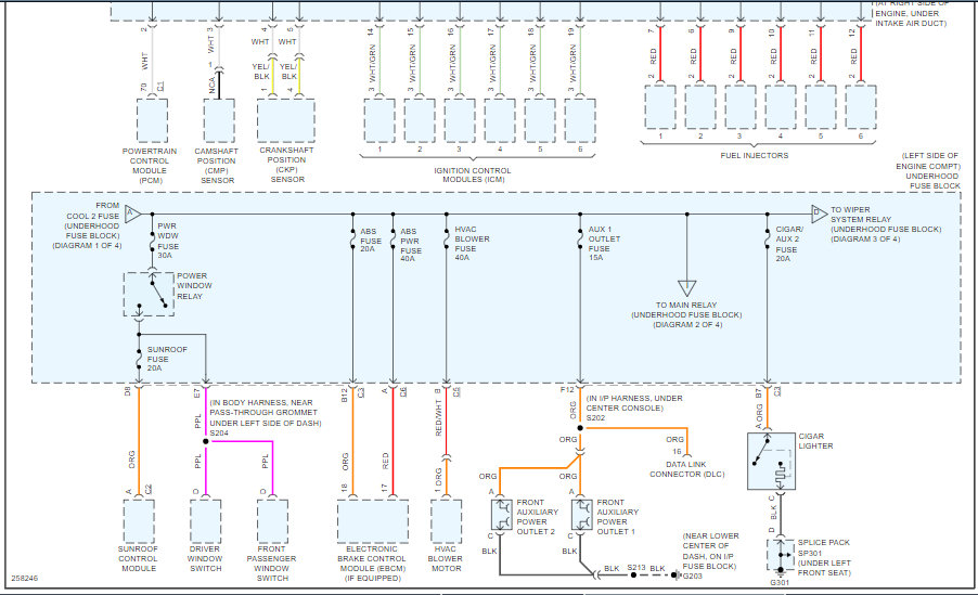

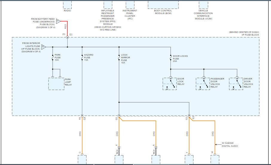

I have the car listed above with 2.2 liter engine in it and I have change the engine wiring harness and I need the diagrams please?

Hello, I'm Danny.
Here is the information you requested. Here is a tutorial for you to view on electrical testing:
I've attached the engine wiring diagrams below for your car. I've cut the pictures into 3 pieces each so you can view larger. Hope this helps and thanks for using 2CarPros.
