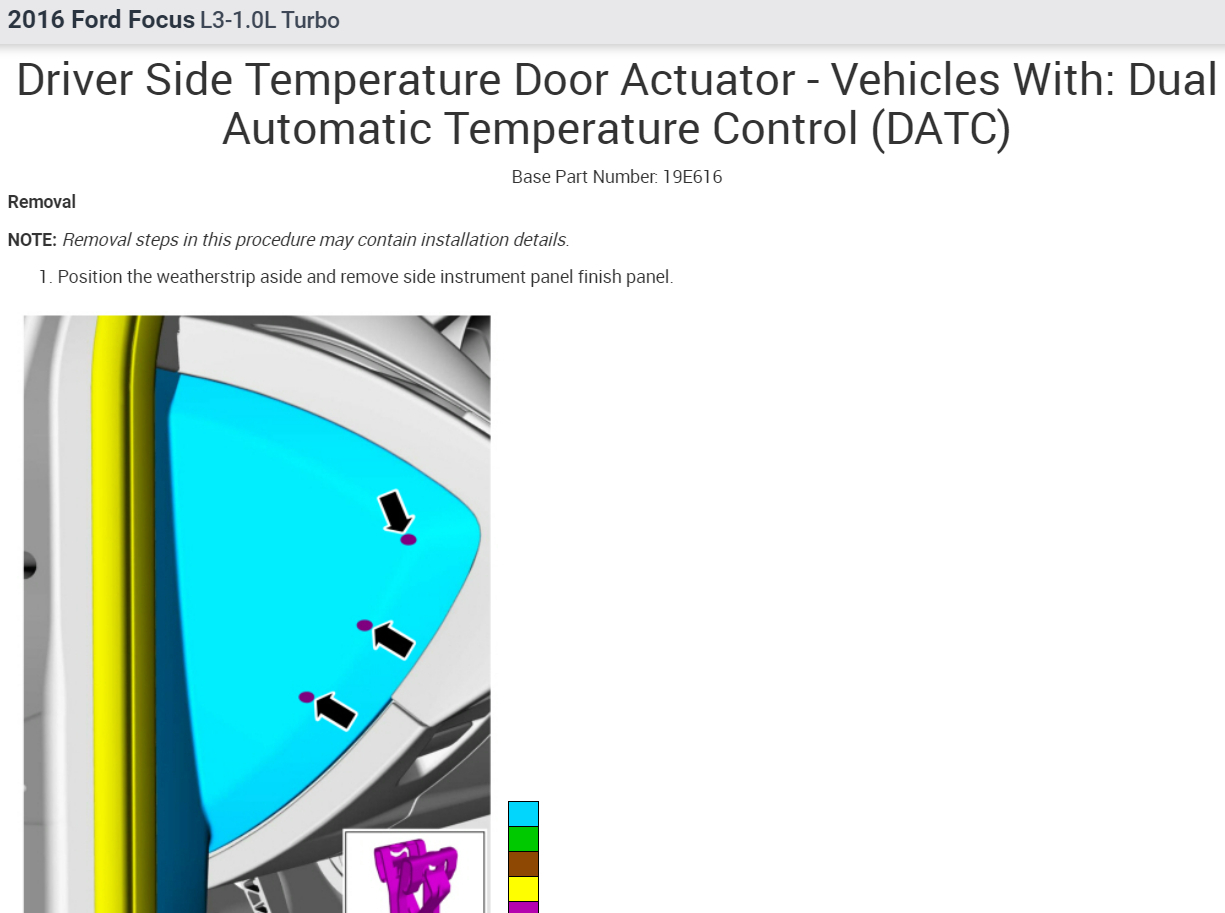

My dual climate zone HVAC is blowing only cold on drivers' side and hot on the passenger in all vent areas (upper windshield/upper body/floor locations). The passenger side is working as normal. Is this a blend door issue? What is the testing procedure on a dual zone climate control unit?
Thanks!
Aug 24, 2023 at 6:44 AM
  • CAR REPAIR CONTRIBUTOR
  • 54,452 POSTS

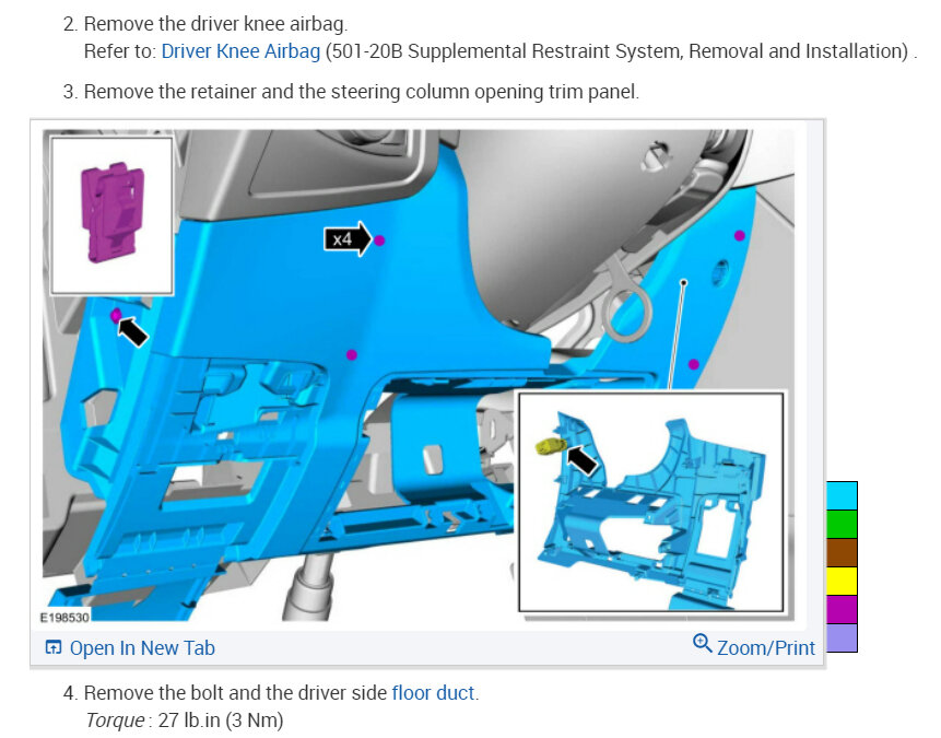

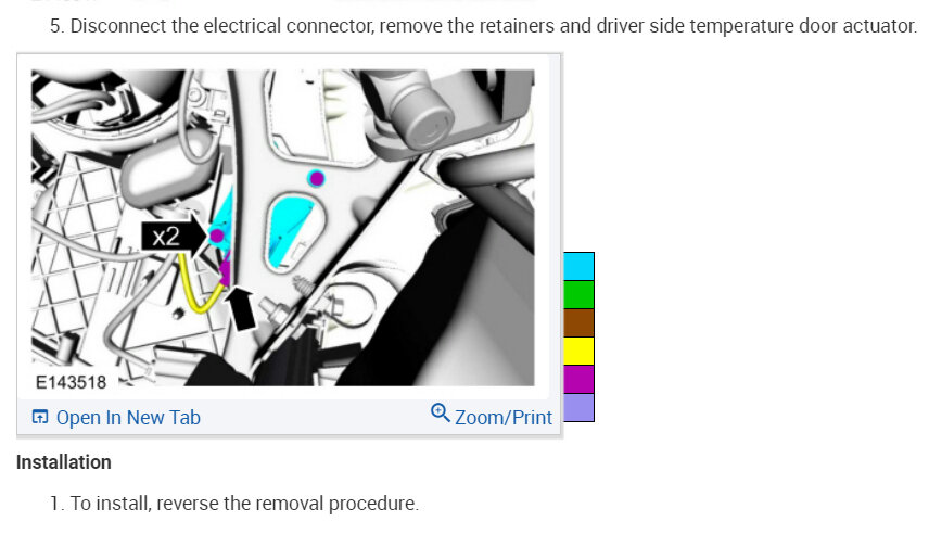

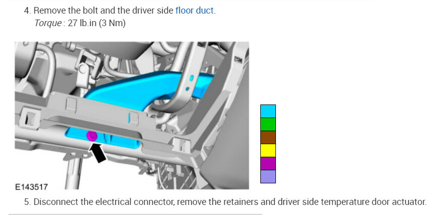

Yes, this happens when the driver's side temperature blend door actuator has gone bad. here is how to change it out, you want to confirm the problem you should do a CAN scan.
You can get a CAN scanner (Controller Area Network) which will work on most cars from Amazon.
https://youtu.be/u-4syLc-ifQ
Here is how to change the actuator out in the images below. Please let us know if you need anything else to get the problem fixed.
