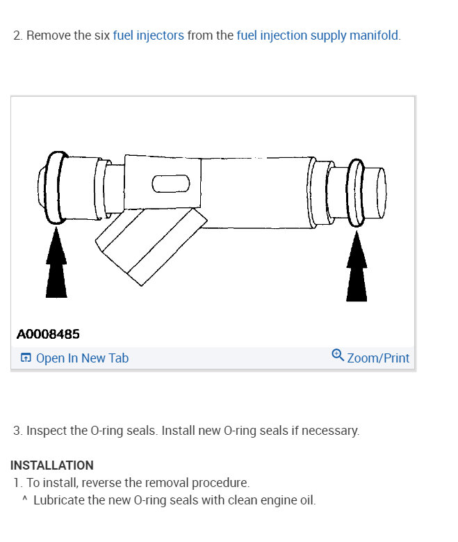

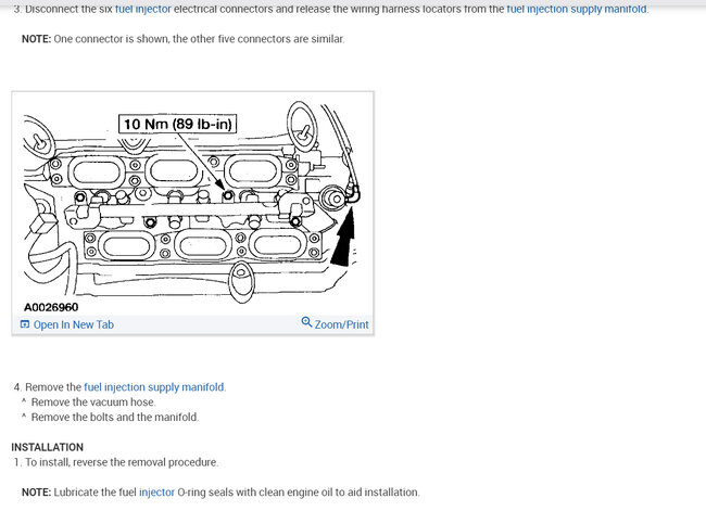

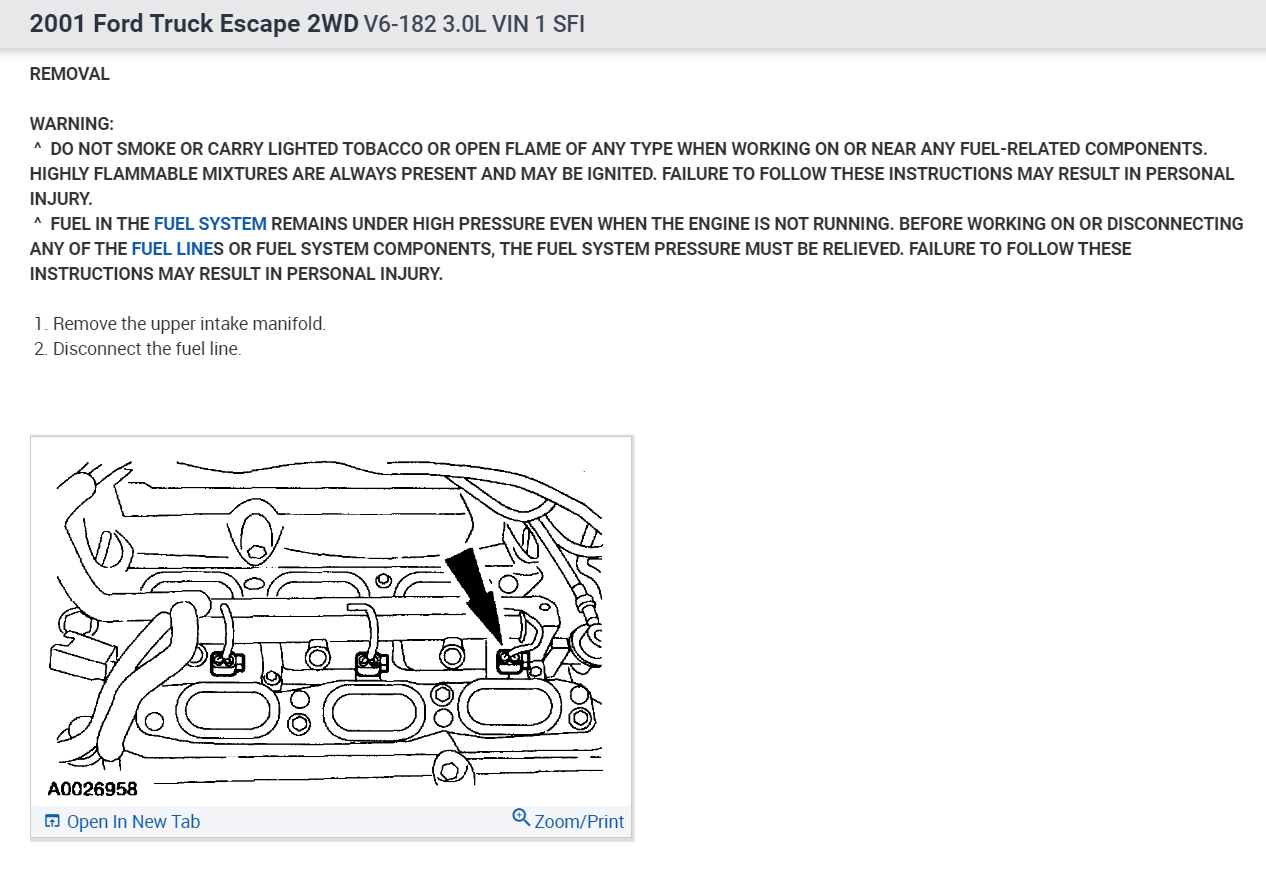

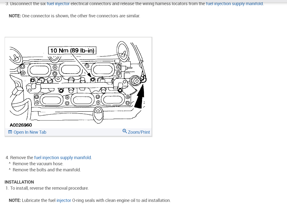

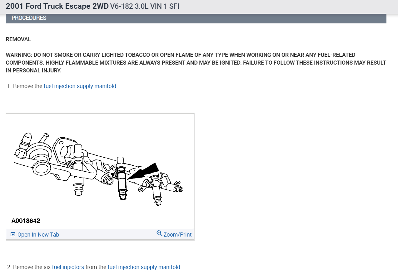

The P0153 trouble code is the oxygen sensor is not properly regulating the fuel levels. So, you have a fuel injector that does not close completely at times. You may be able to remove the spark plugs and look for the one that is darker than the others which will be the cylinder that is having the issue. Here is a generic guide on how to replace the injectors that will help walk you through the process with instructions below to show you how on your car.
https://www.2carpros.com/articles/how-to-replace-a-fuel-injector
