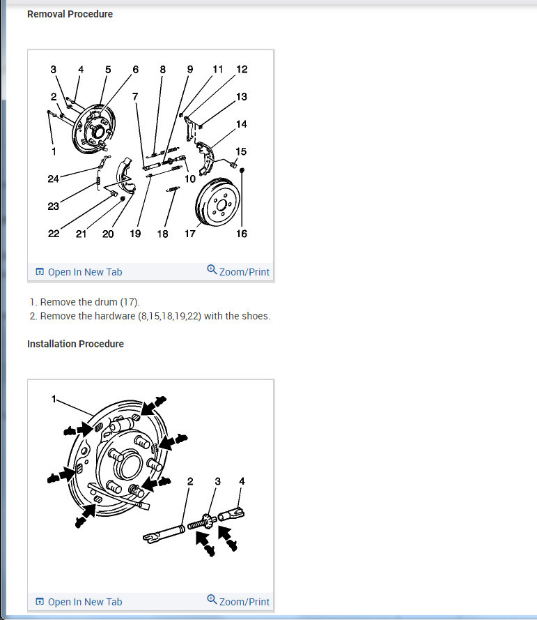

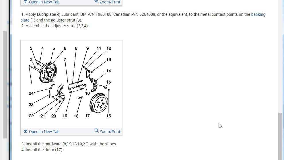

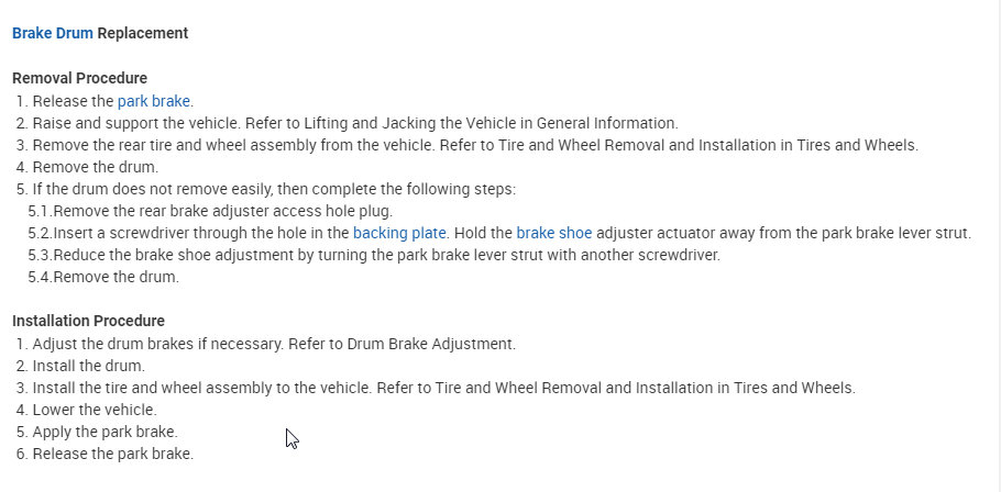

Here is a guide that will help with this:
https://www.2carpros.com/articles/how-to-replace-rear-brake-shoes-and-drums
Below is the process from the manual that will help with this as well.
Please let us know if you have other questions. Thanks
Wednesday, June 9th, 2021 AT 12:30 PM (Merged)

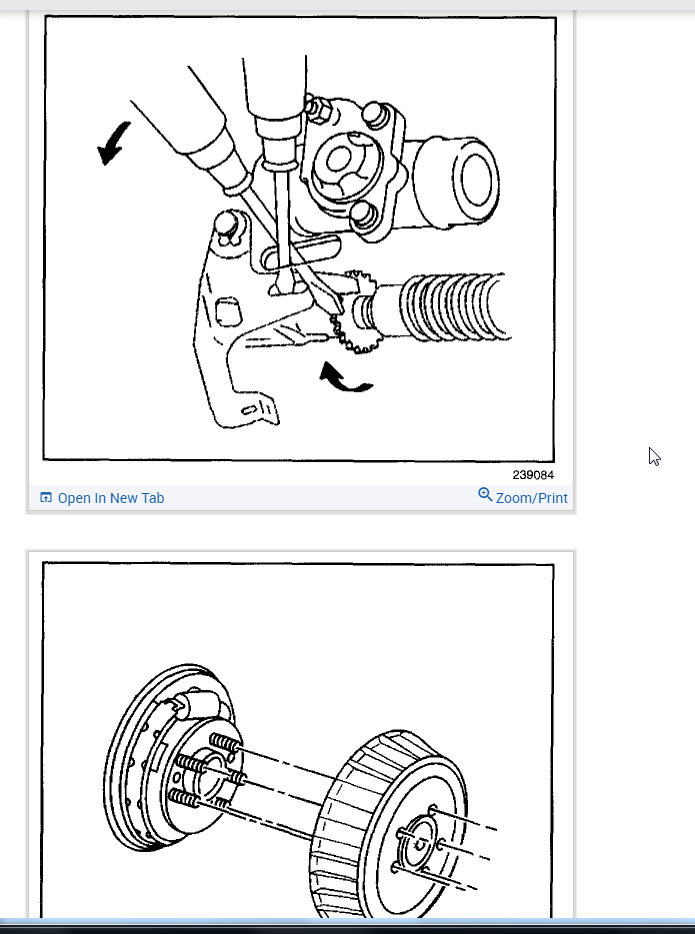

My husband has a 2005 Pontiac Vibe. He took the Brake Drum off and at some point had our nephew step on the brake. Well after doing that he figured out that the brake drum will no longer go on and we can not find anything that states what to do. We have tried moving the Adjuster, but to no avail. Please help!
-1
CARADIODOC
  • 34,463 POSTS
Check that the shoes are seated against the large anchor pin on top. You'll probably have to pull them away from the backing plate so they can spring back.

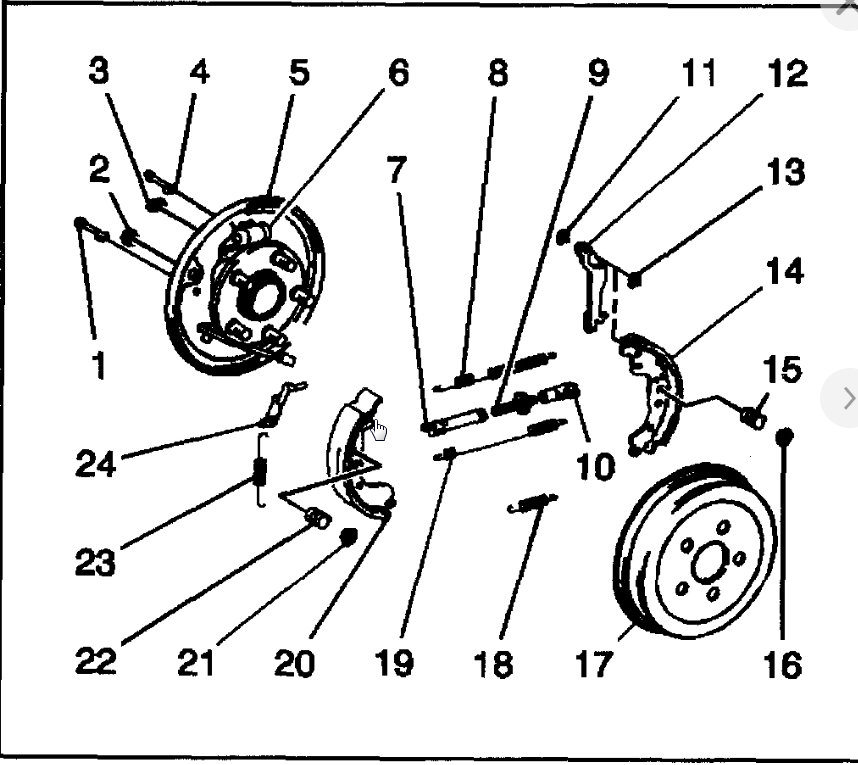

MARS1022
  • 2005 PONTIAC VIBE
  • 1.8L
  • 4 CYL
  • 218,000 MILES
Was rotating my tires last night so I put my spare on the back left side and moved it to the front and when going to put the other tire on the rear the spare came off fine but I noticed when tightening the lug-nuts by hand the wheel would spin freely. I didn't think much of it until I went to lightly tighten them with my 4 way while it was still jacked up and then I realized the tire spinning like that had never happened before. The point it was spinning from was the front facing side or the drum. A weird noise is now coming from that brake and I'm worried I'm going to lose fluid and pressure.

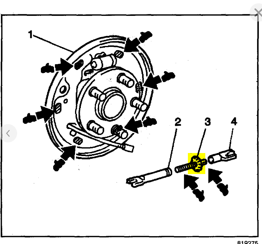

Depending on the noise, it may just be the linings dragging or they are coming apart. Either way I would just take the drum off and inspect them. If they just need to be adjusted, you can do that by spinning the adjuster that I highlighted in the attachments.
If you can, get a recording of the noise so we can hear it and that may be able to tell us what it is.

My rear drum will not come free. How do you get it loose? Any tips?
Wednesday, June 9th, 2021 AT 12:31 PM (Merged)
DEMERS669
Purchase two M8 1.25 x 40 bolts and screw them into the drum (there are 2 holes, 180 degrees opposite each other at the inner part of the drum). Using a socket, turn each bolt, alternating between the two and slowly turn the bolts clockwise. This will cause the drum to loosen up and come off of the wheel hub
