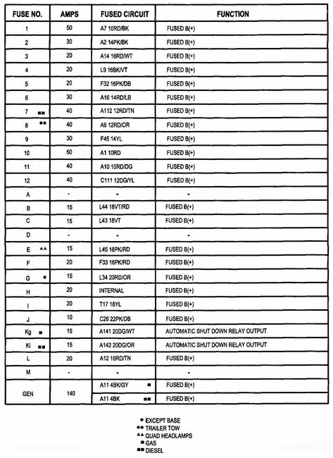

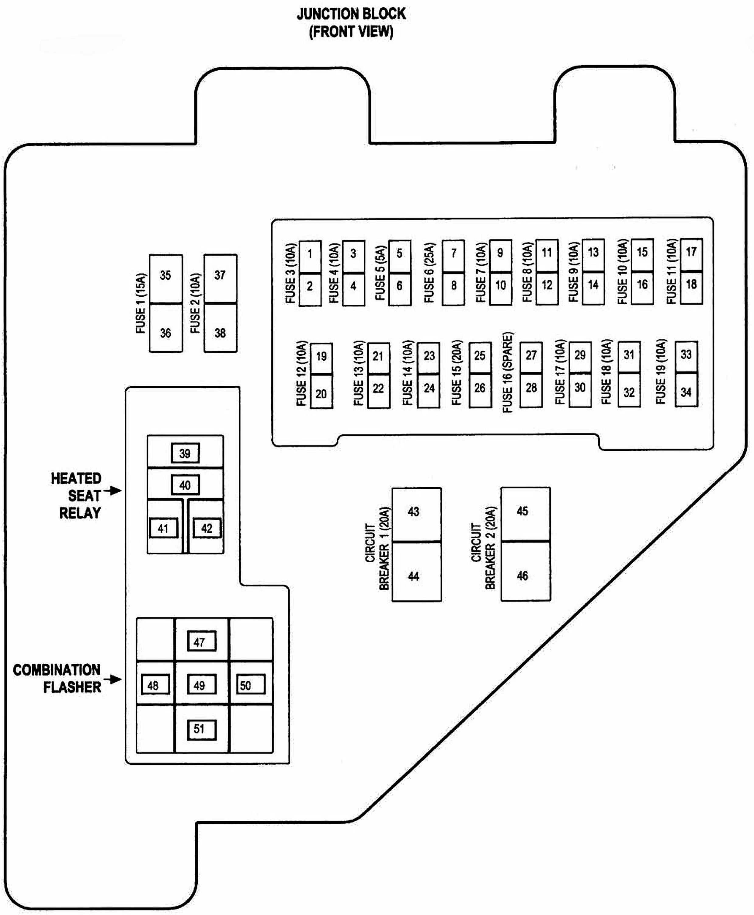

It will not start but turns over good. Also the gauges do not work.
Jun 1, 2018 at 2:26 PM
  • CAR REPAIR CONTRIBUTOR
  • 110,190 POSTS

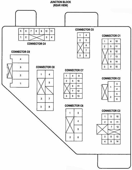

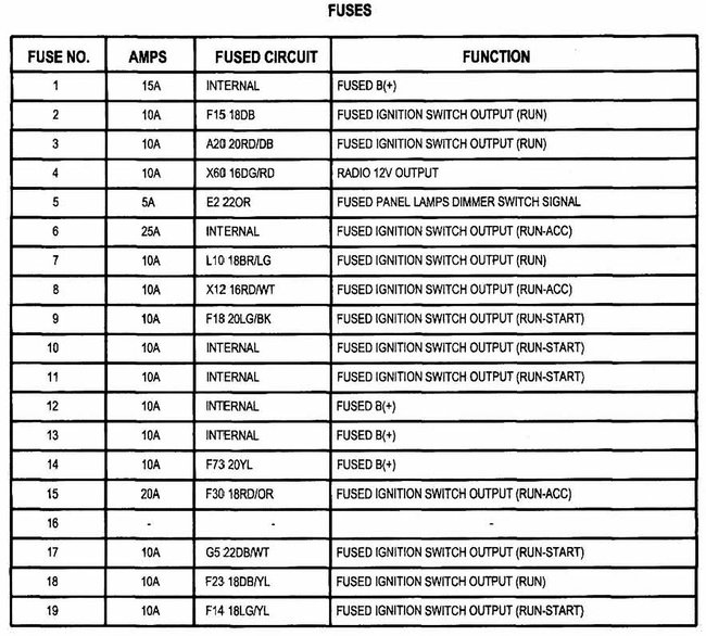

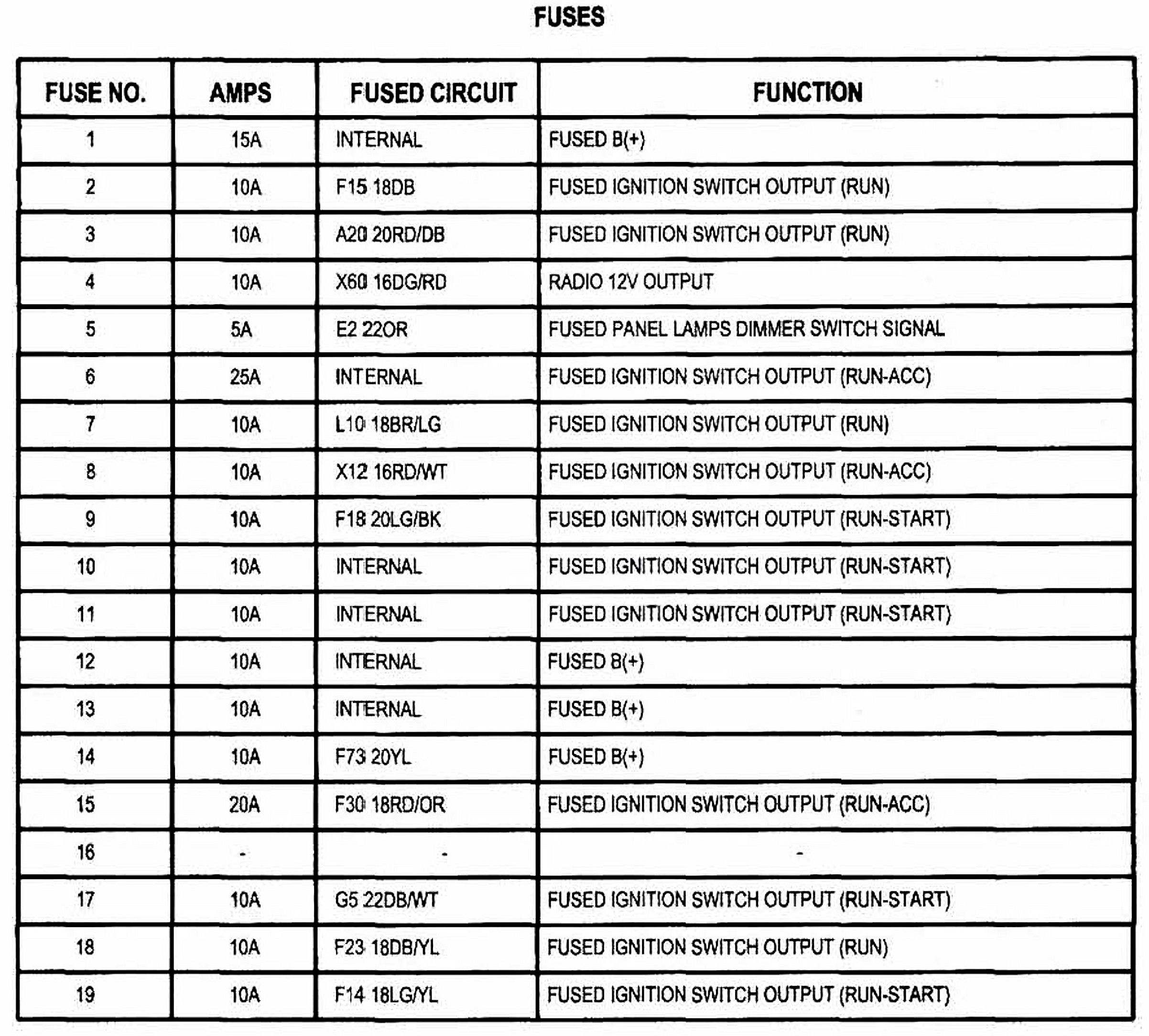

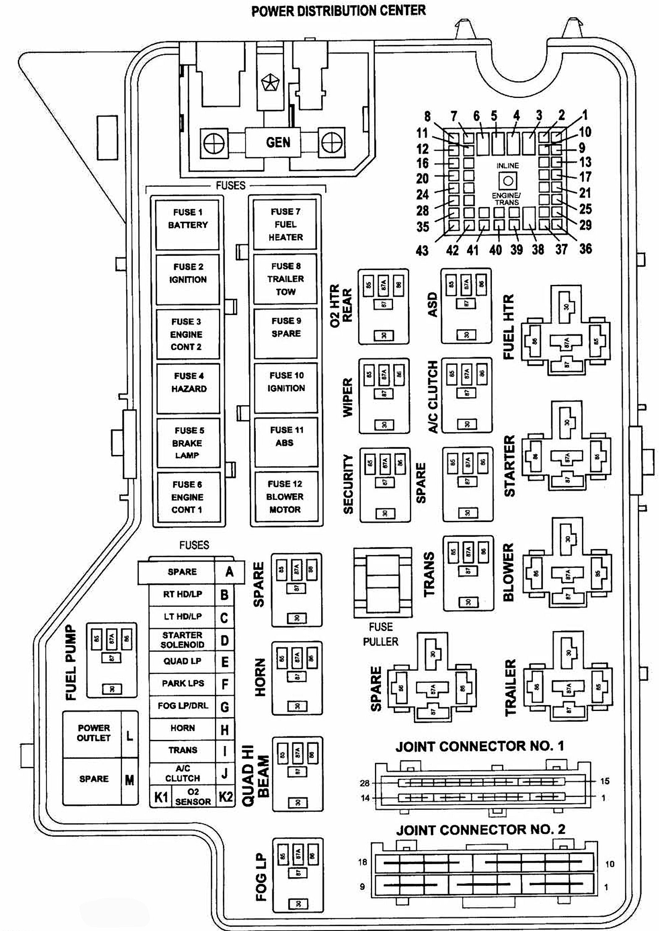

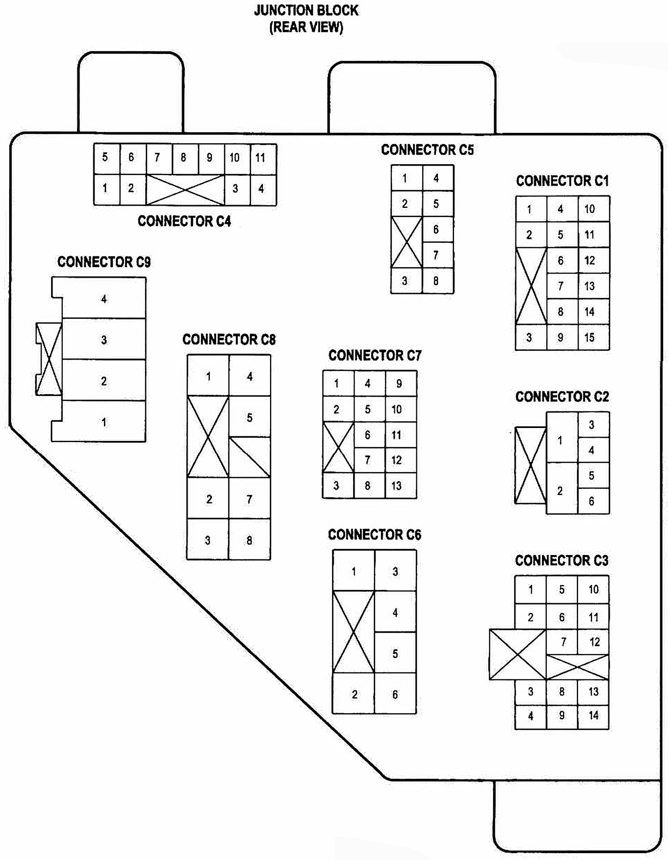

Hi and thanks for using 2CarPros.com We are going to start easy with this issue. First, I need you to check all main fuses under the hood in the power distribution box. My primary concerns are fuses 1, 2, 3, and 6. These fuses are required for the engine to run or are related to the primary power to the truck. See pictures 1 and 2. If they check good, check the fused ignition switch output fuses. See pictures 3, 4 and 5.
Here are general directions for checking for power at the fuse and if the fuse is good:
Let me know what you find.
