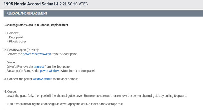

Driver's side window up it comes out of the track at the top?
1995 HONDA ACCORD
200,000 MILES
KERI L KAISER

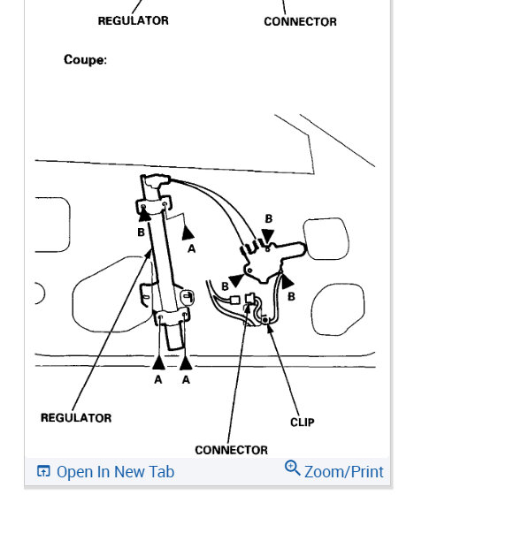

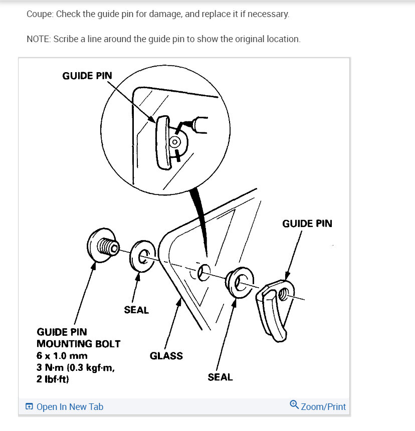

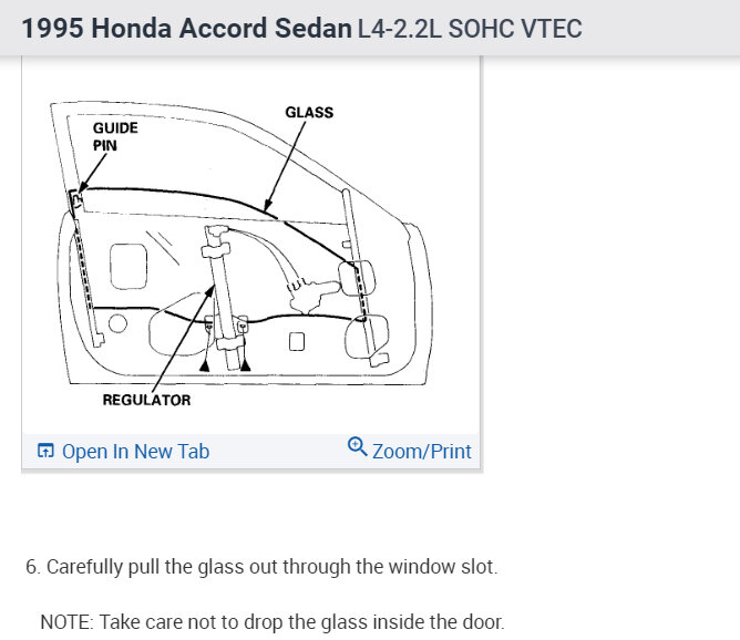

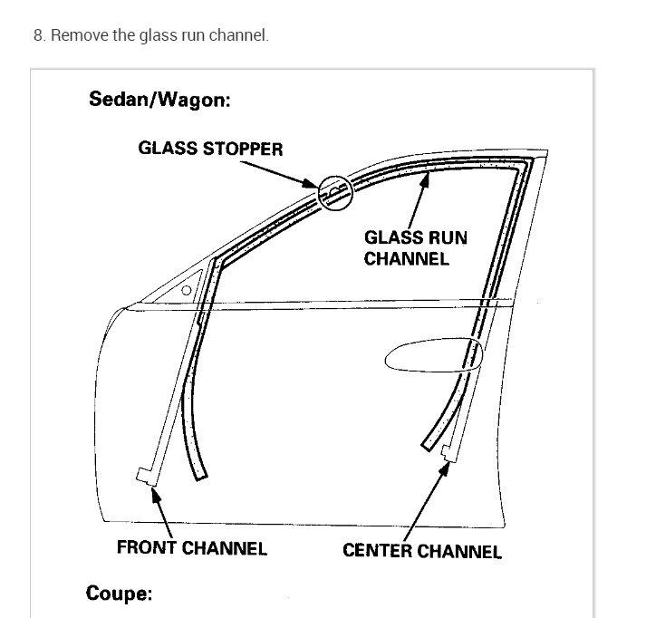

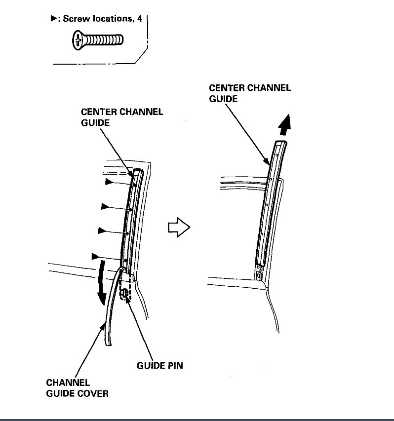

When I roll the driver's side window up it comes out of the track at the top. I noticed a perfectly round hole in the top corner. I think a plug fell out, but I don't know what it is or where to get a replacement. I think it is supposed to keep the window in the track as you roll it up. Can someone tell me what it is called and/or where to get it?
Jan 9, 2023 at 9:44 PM
  • CAR REPAIR CONTRIBUTOR
  • 54,199 POSTS

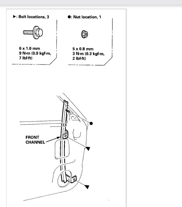

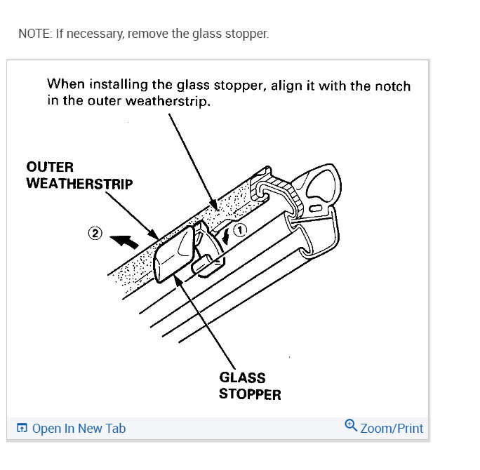

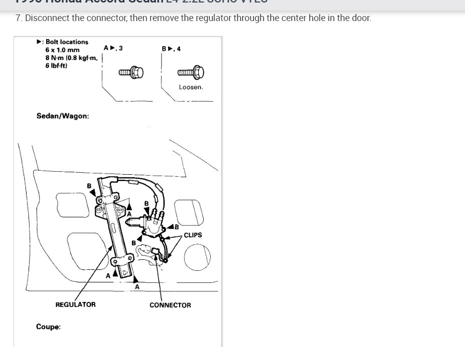

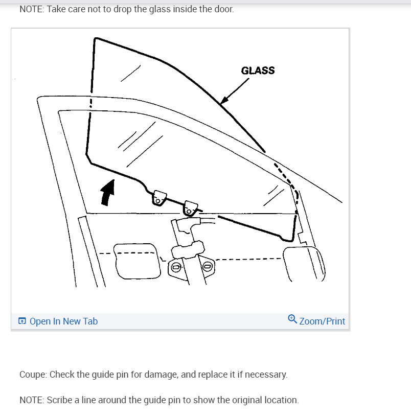

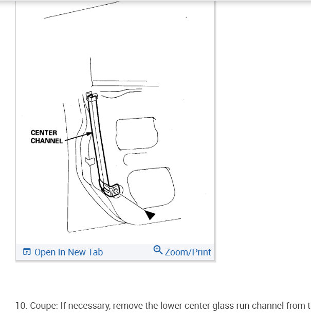

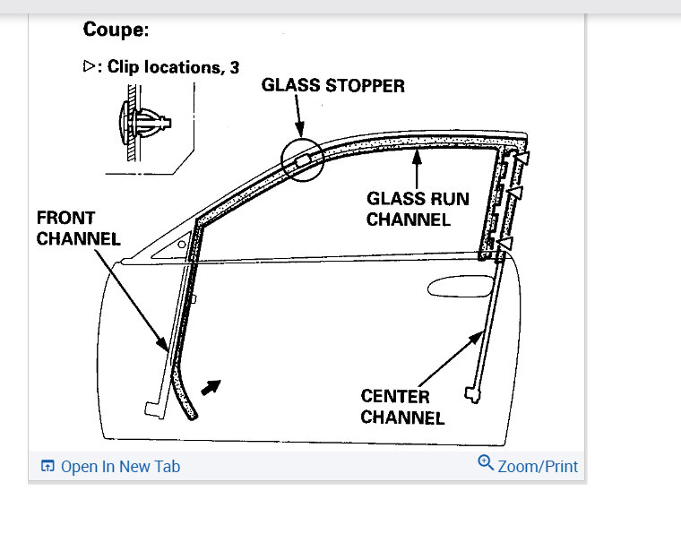

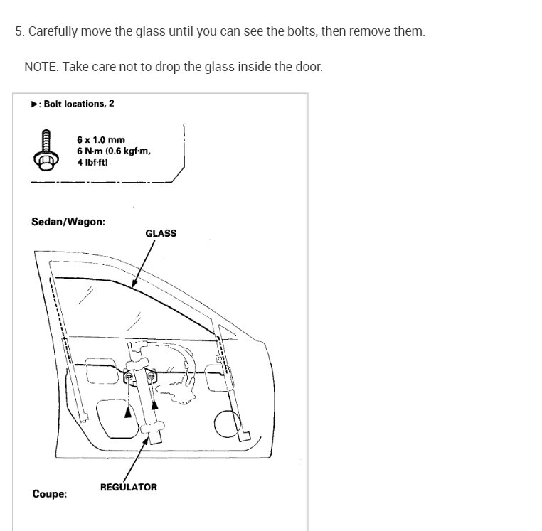

Yep, you are correct there is a plastic window guide button which is called a "guide pin" you get at an auto parts store. The instructions on how to change it out are in the images below. Check out the images (below). Let us know what happens and please upload pictures or videos of the problem.
