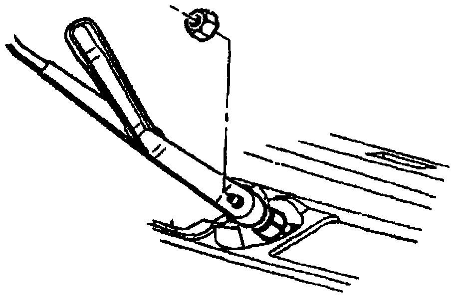

Wipers were on and then all of a sudden the driver's side stopped. The passenger side works fine as well as both sides washers. I can move the driver side up and down with no resistance. when I turn the wipers on the passenger side works fine, however the drivers side doesn't work at all. You can see it move about a 1/2" up and down while the passenger side is fine.
Apr 27, 2019 at 10:56 AM
  • 110,190 POSTS
Welcome to 2CarPros.
A few things may have happened. The wiper arm may have come loose, stripped, or there is a problem with the linkage.

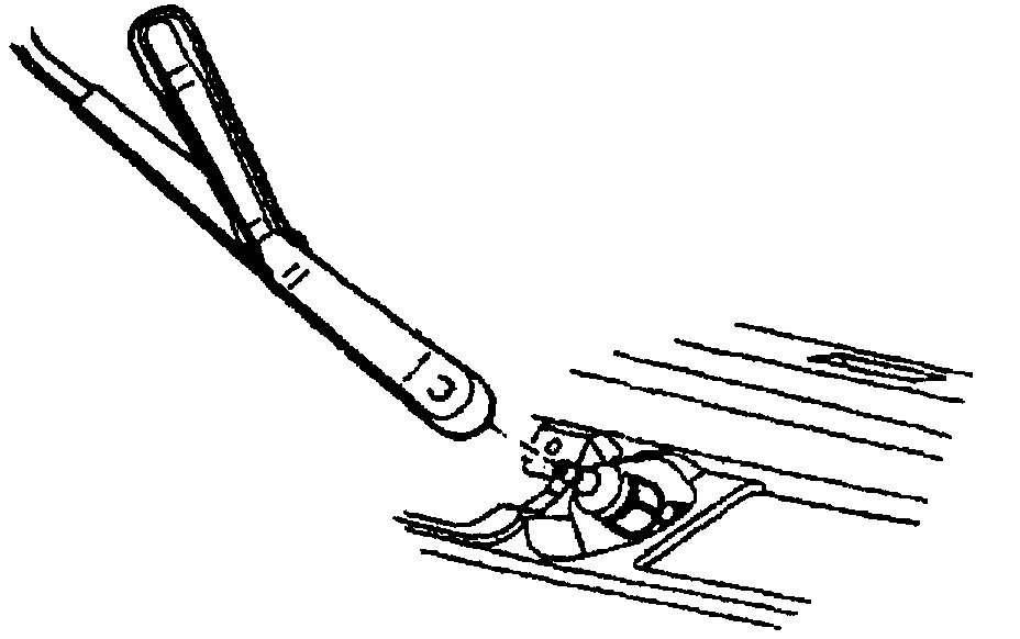

What I want you to do is first, confirm the nut holding the arm to the wiper transmission is tight. If it is, remove the wiper arm. Here are the directions for removal. The attached pics correlate with the directions. Also, you will see how to access the nut to confirm it is tight. Once you remove the arm, check it to see if it is stripped where it mounts on the transmission. Also, if it isn't stripped, with the wiper arm off, turn on the wipers and see if the transmission is moving.

1. Mark the wiper park position on the windshield with a suitable non-permanent marker.
2. Remove the cover from the wiper arm nut.
3. Remove the wiper arm retaining nut.
picture 2
4. Remove the wiper arm from the wiper transmission drive shaft.

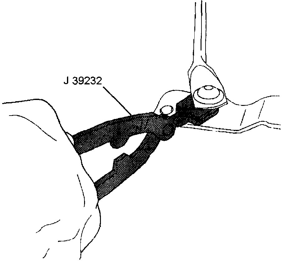

If the transmission doesn't move with the arm off and wipers on the linkage under the cowl at the base of the windshield may have come off. The wiper motor is mounted on the firewall under the hood. When on, it turns the linkage which is attached to each wiper. There is a ball joint connection at each side. See pic 3. It shows the joint being removed with a special tool. That may have come apart.
Let me know what you find so I can better help. Also, I will tell you that often times the wiper arm strips and needs replaced. You will know once it is removed. Regardless, I'm hoping it just came loose.

I found the wiper arm lock nut only finger tight. I took it off and check the spline (it's a little worn), put arm back on and tightened it really good. It seems to work fine now. If the spline/wiper arm gets to worn I'll have to replace them. I'm not sure if the spline that's connected to the linkage is a replaceable part or not.

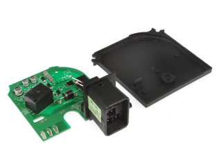

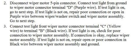

I have had the same problem as many other s10 owners have had, where the wipers used to work (intermittently), now they dont work at all. I have replaced the connector to the motor and it worked great, very briefly. i read on some forums to re-solder some of the connections on the board. I did them all, and still nothing. Please help. 98, 4.3l, 2wd
Apr 30, 2019 at 2:23 PM (Merged)
ZACKMAN
  • 4,202 POSTS
Have you considered replacing the pulse board? I have seen two Blazers with similar problem, and the pulse board replacement cured the problem.
https://images.2carpros.com/forum/automotive_pictures/55316_906136007_1.jpg
Available at your local parts store, Dorman 88136 retails for about $30.

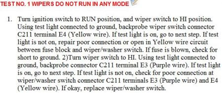

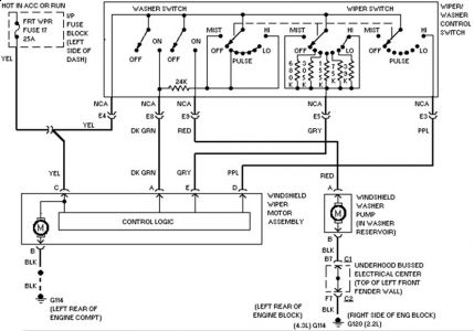

i have replaced the pulse board module, and still nothing, the fuse is good(obviously) is it possible that i have a bad ground or something?
ZACKMAN
  • 4,202 POSTS
It is quite possible. Here is the diagnostic for your problem and the wiring diagram.
https://images.2carpros.com/forum/automotive_pictures/55316_98s10wiper1_1.jpg
https://images.2carpros.com/forum/automotive_pictures/55316_98s10wiper2_1.jpg
https://images.2carpros.com/forum/automotive_pictures/55316_98s10wiper3_1.jpg
KDIZZY42
thank you very much for the diagnostic and wiring diagram....this will definitely get me to the bottom of the issue...ive looked in several places for the diagram, but to no avail. Thanks again.
