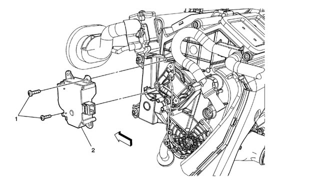

No heat on drivers compartment side. A/C and heat work on passenger side. Have been hearing clicking noise from HVAC system. Clicking noise started in summer but would stop.

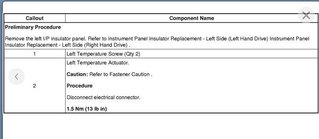

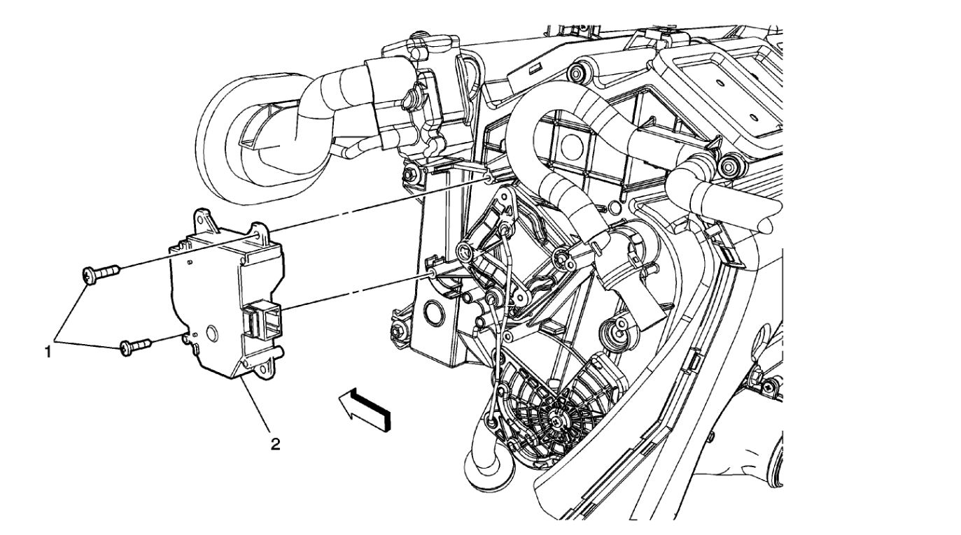

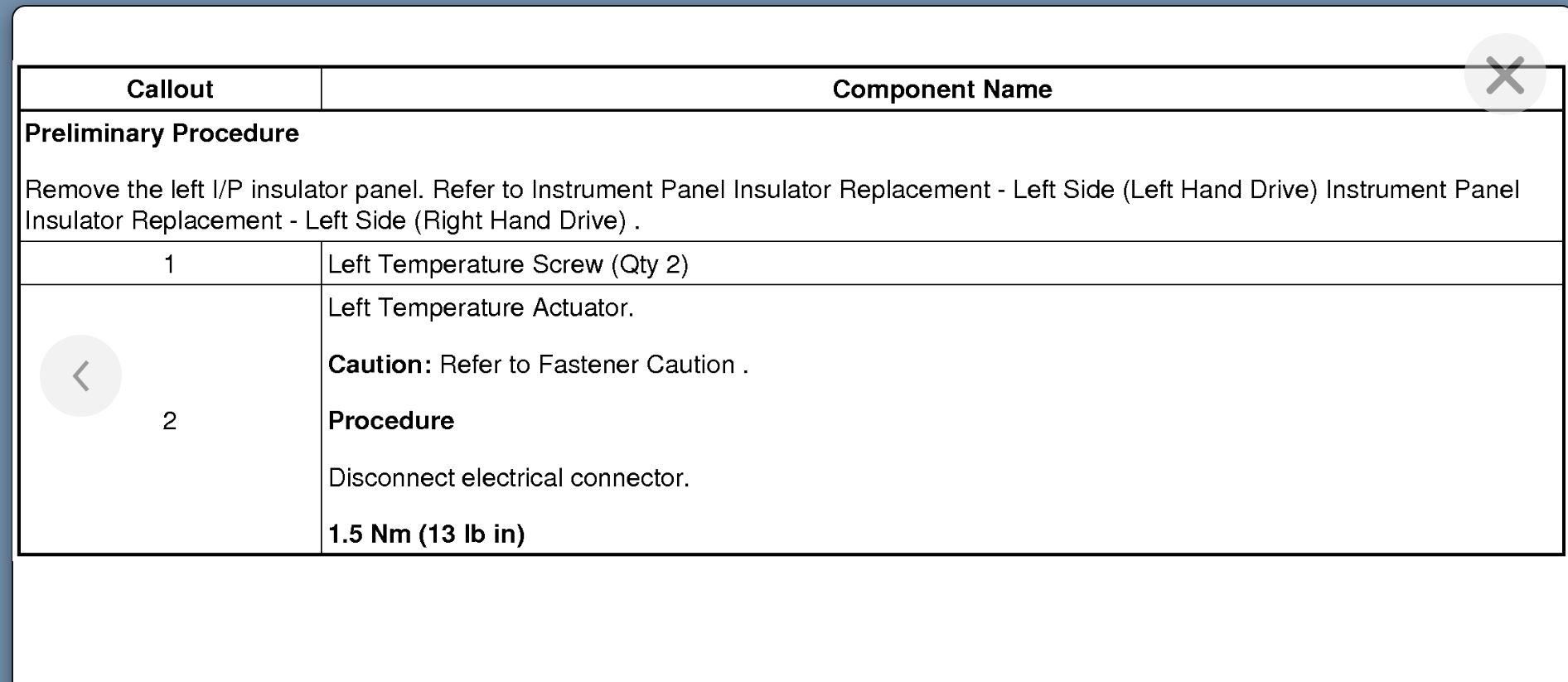

It's behind the lower kick panel on the drivers side and to the right. If you remove the 3-4 7mm screw holding the lower panel in below the steering column you can get to it. Below is the location and instructions.

Thanks! It's tight in there, but it looks like it can be done.
