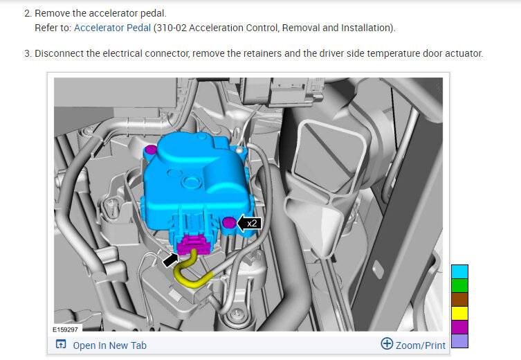

I have the car listed above Titanium, and I am having issues locating the HVAC Actuator for removal.
Thursday, August 29th, 2024 AT 12:45 PM
  • 110,192 POSTS

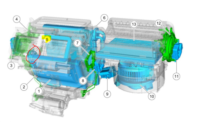

If this has dual automatic climate control, it is above the throttle pedal which needs removed to access it. If you have manual climate control, it only has one actuator.

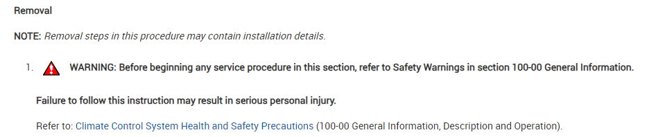

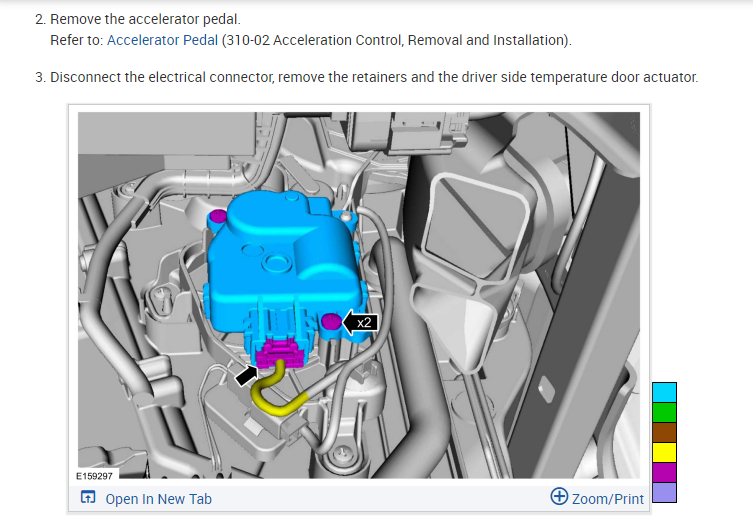

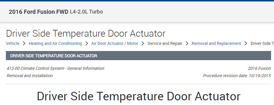

If you look at pic 1 below, it shows the location. The remaining pictures are the directions for replacing it.
Let me know if this helps.
