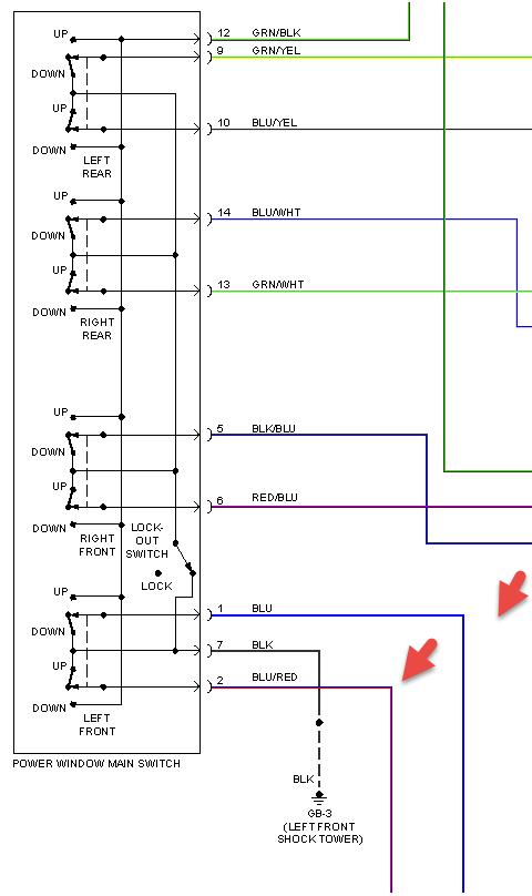

The switch D1 which connect to under driver side dash board gets rusted, some wires are just ripped off, can you supply the wiring diagram?

arrows point to motor wiring.

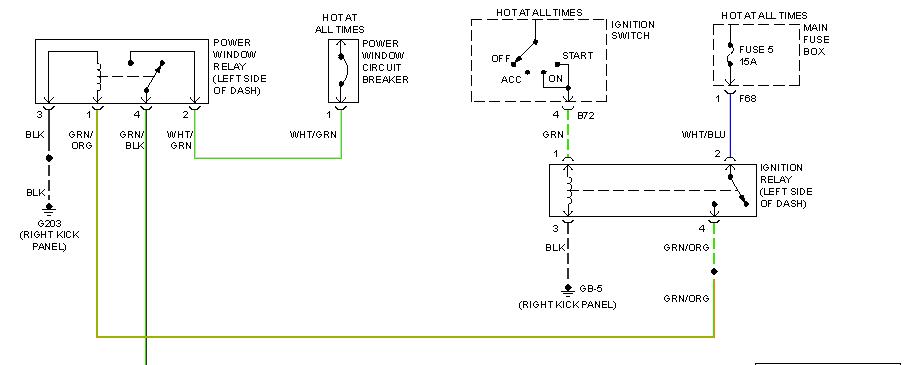

Than is a lot. But this is not what I want, this is diagram for the main switch, I mean the connector before it which is located underside of dashboard.

you'll have to get a manual for that as that is in our power dist circuits and they would be to small for you to see them.
