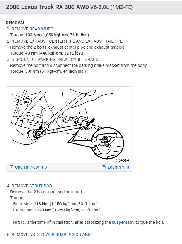

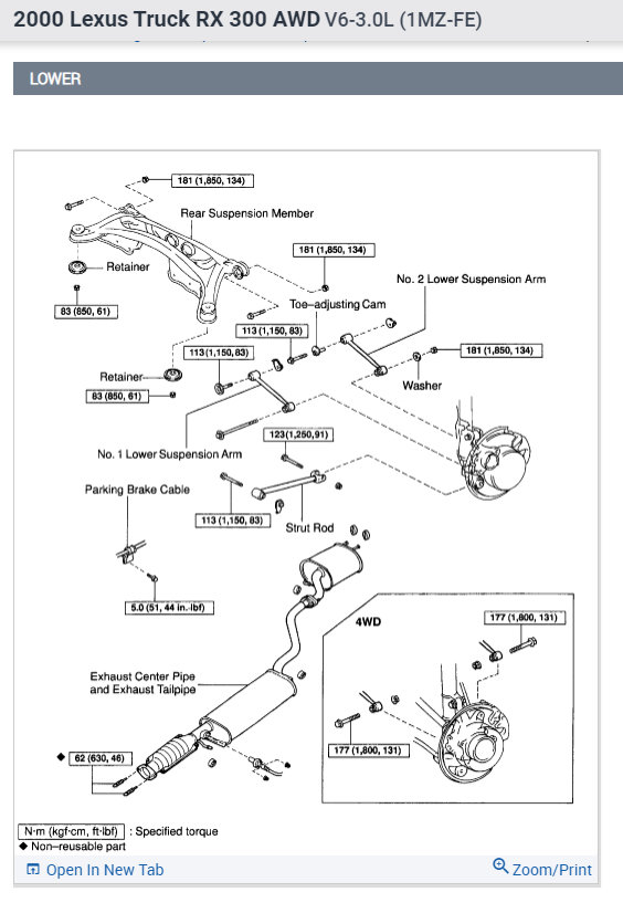

Driver lower rear control arm replacement how do i remove the camber bolt off, what size is it, can I get a diagram of the rear end?
2000 LEXUS RX 300
156,000 MILES • 3.0L • V6 • 4WD
CPERRY54
  • 35 POSTS
I need to change the driver rear lower control arm, how do i go by getting the camber bolt off, and what size is it, and a diagram of the rear end.
Jul 19, 2022 at 10:00 PM
SQM
  • CAR REPAIR CONTRIBUTOR
  • 6,383 POSTS

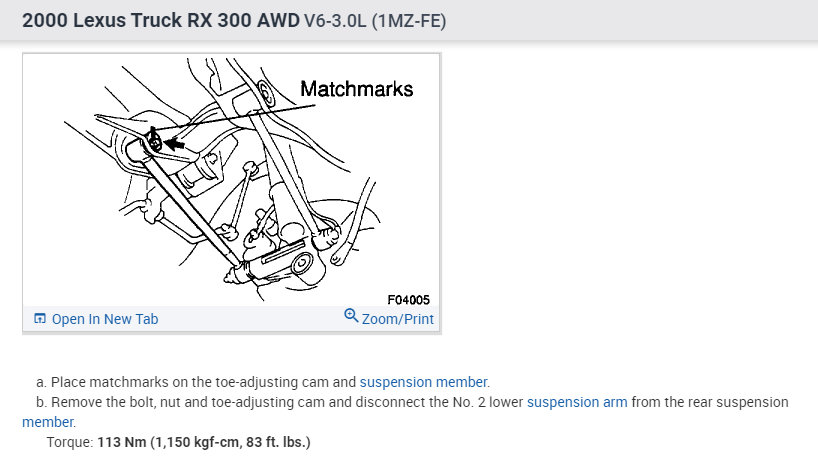

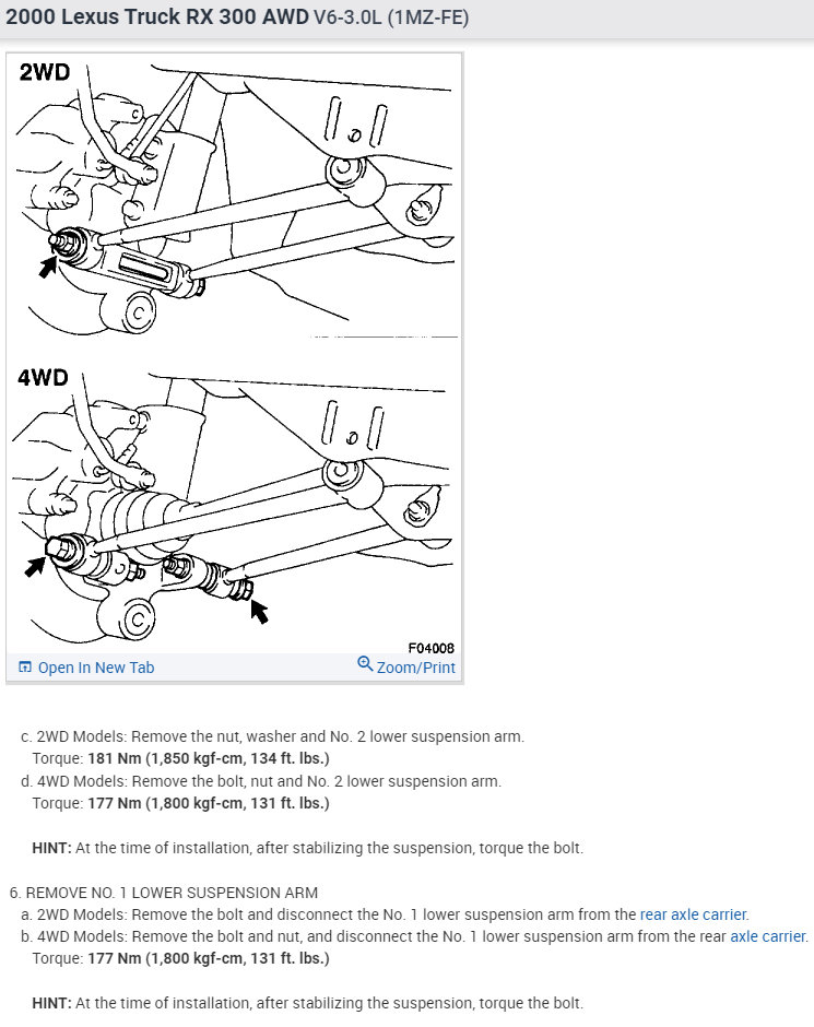

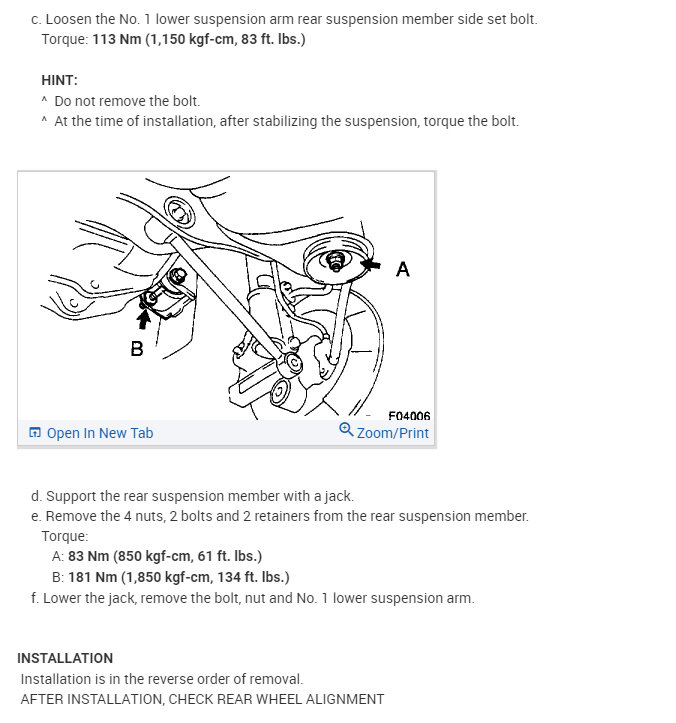

See attached for the control arm replacement procedure.
It also has all the torque specifications.
Remember that you will need to have the vehicle aligned after replacement of the control arm.
Let me know of any questions.

The control arm is the driver lower rear, what type of nut is on the Camber bolt? Does schematics that you sent me was not viewable?
Jul 21, 2022 at 6:40 PM
SQM
  • 6,383 POSTS
Unfortunately, the catalog does not specify the cam bolt size, it is a standard socket you will need to remove it.
Were you unable to see the diagram with the torque specs?
