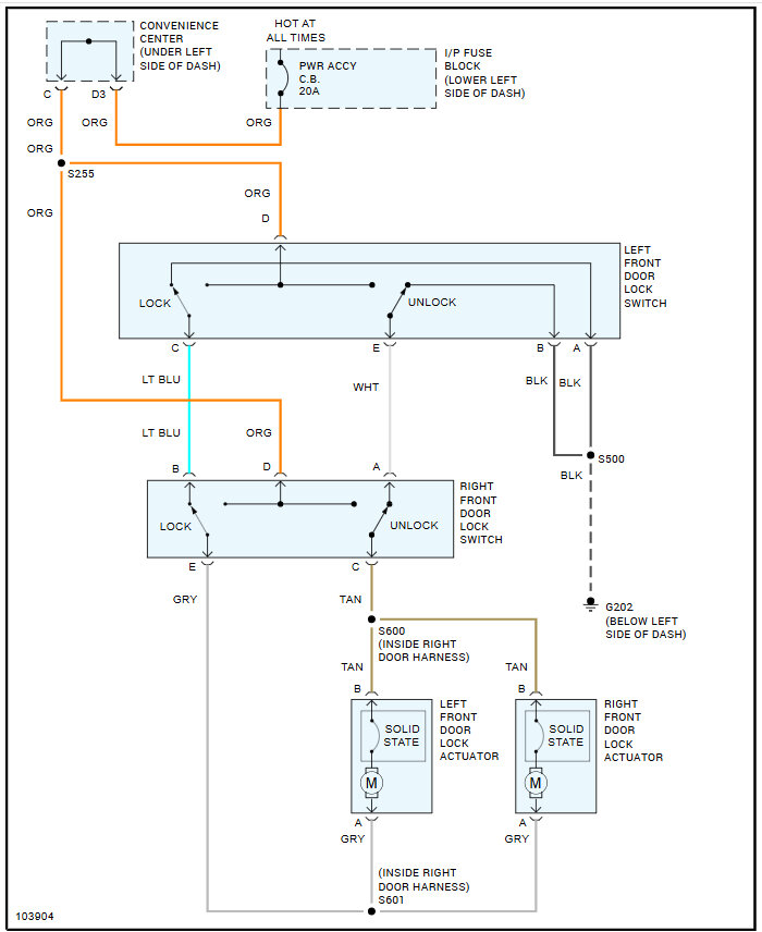

I'm hoping someone could please help me get some wiring diagrams for the driver's door lock switch
A diagram of the master door lock switch connector with wire colors and what the go to and do.... would be so very helpful. i have the connector and it has 8 wires coming out of it. (It's a 12-pin connector but 4 pins are empty with no wires).
Someone has tried and failed to put a cheap alarm system in it and after failing to install the alarm correctly, they just left the alarm module zip tied under driver knee bolster and unplugged. With half of the wires connected to things (I'm assuming wrong things because it didn't work.) so I am disconnecting the alarm module wiring. But they cut some wires in half and attached alarm wires to where they thought they were supposed to go but probably don't....

Hello Kurt,
I am sorry to hear about your troubles; we don't know why these things happen they just do. You are correct in removing the alarm system, they cause nothing but problems. This is why I like automotive repair, no matter what it can always be fixed. I would check out where the wires go from the aftermarket alarm and reconnect the wiring as the factory had it. Here are the wiring diagrams for the door lock switches and lock actuators. I hope you feel better; I will help with the repair the best I can so please ask for additional information if needed. Stay well. Ken L - Check out the images (below).
