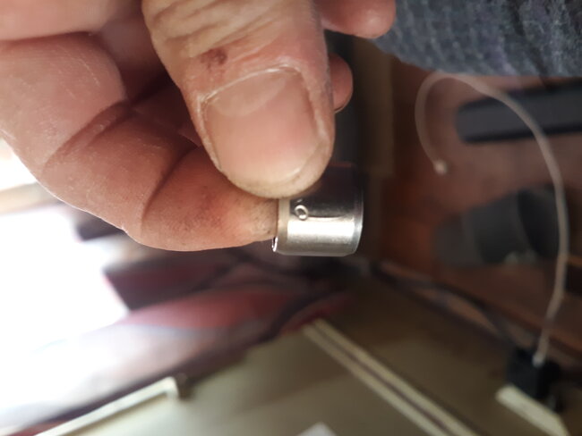

I have two new dowels to put in engine block they have a circle mark on one end. does this go up or down or is it how deep they go?

It does not matter which side is up, install the dowels using a brass hammer and they will only go down so far and stop, this is the height they should be at.
