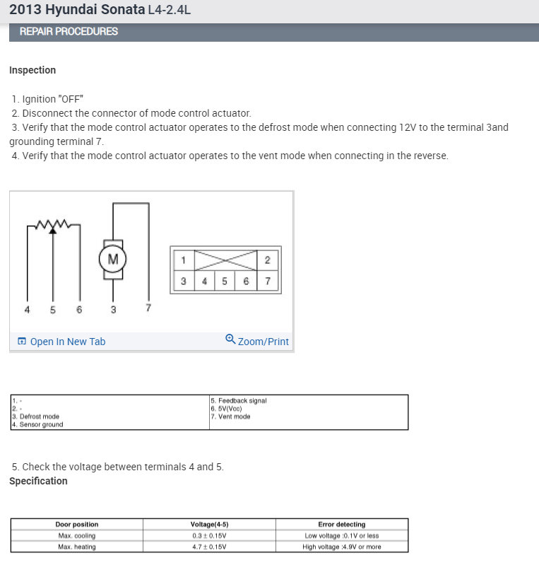

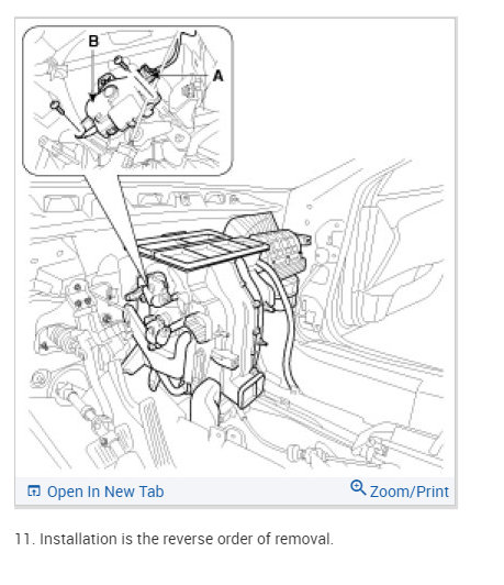

Vehicle listed above is a GLS model. The actuator stays only on in windshield mode. A/C (hot/cold) works fine. I believe the actuator has simply given out. Saw your video for replacement. Seems easy to replace. I will make sure that the "leveler switch," ie. windshield, sides, and front blowers move unobstructed, before replacing. Question: The one I want to buy doesn't look like the original manufacturer's actuator. Hard to tell. Please suggest the item number so I can order it from you all. Dorman 604-327 The one on Amazon is $79.00! Thanks, Tony.

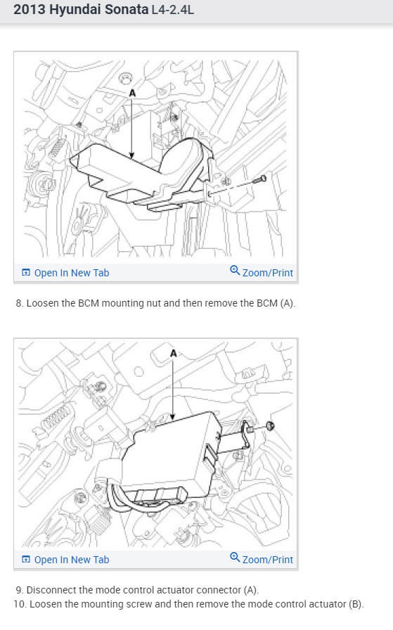

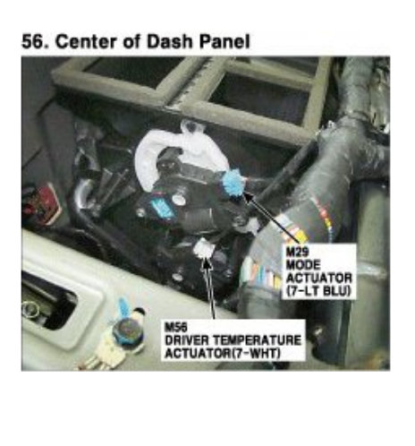

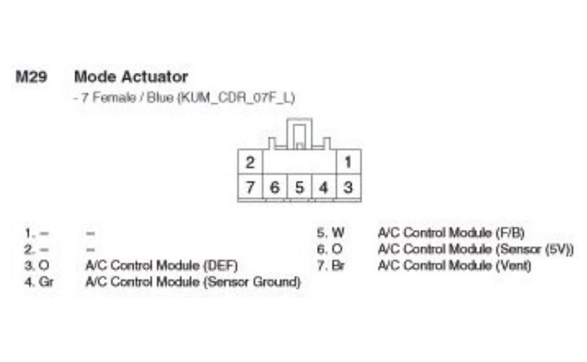

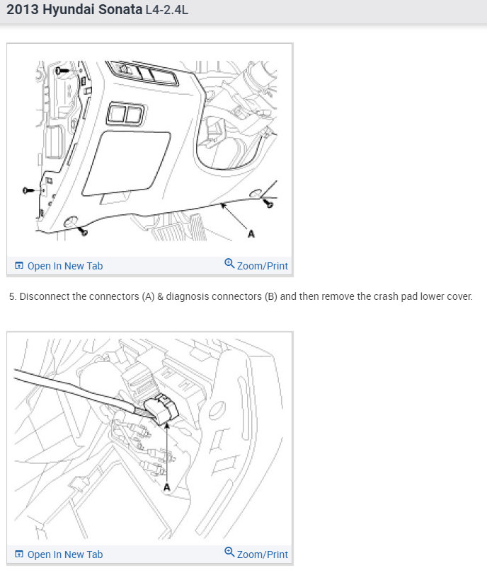

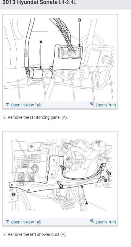

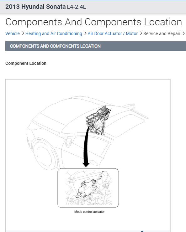

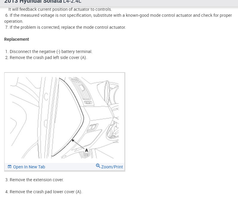

The actuator that controls where the air will blow, is called the mode door actuator (the blend door actuator is the one that changes from hot/cold).
The mode door actuator is located in the HVAC box. I have attached diagrams below.
Please note that here are 2carpros we provide expert advice on your car repair, we do not sell parts.

Well, you know if you do not feel comfortable tackling this is it a good idea to take it to a shop. It does require removal of several components.
Just call the dealership and ask for a quote (if they can give you one over the phone), that way you know what to expect.
Maybe call one of the reputable independent shops in your area too just to have a complete picture of the cost.
