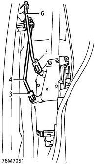

3. Remove retaining clip, private lock to latch operating rod, at latch end.
pic 1
4. Remove control rod from latch and private lock.
5. Remove retaining clip, outside handle to latch operating rod, at latch end.
6. Remove control rod from latch and outside handle.

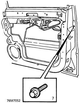

7. Remove bolt securing rear of outside handle.
pic 2
8. Slide outside handle forwards. Pull handle out, release rear of handle from door.
pic 3
9. Remove handle from front fixing by pivoting rear end of handle out.

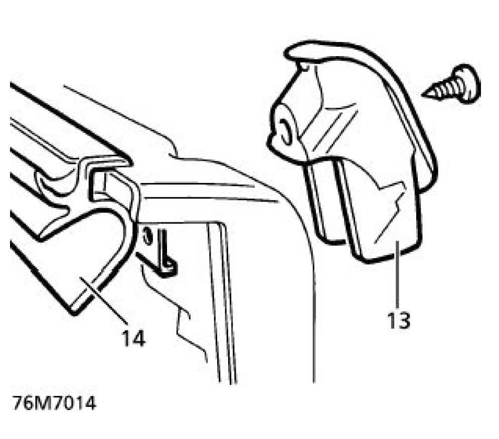

1. Release cheater panel.
pic 4

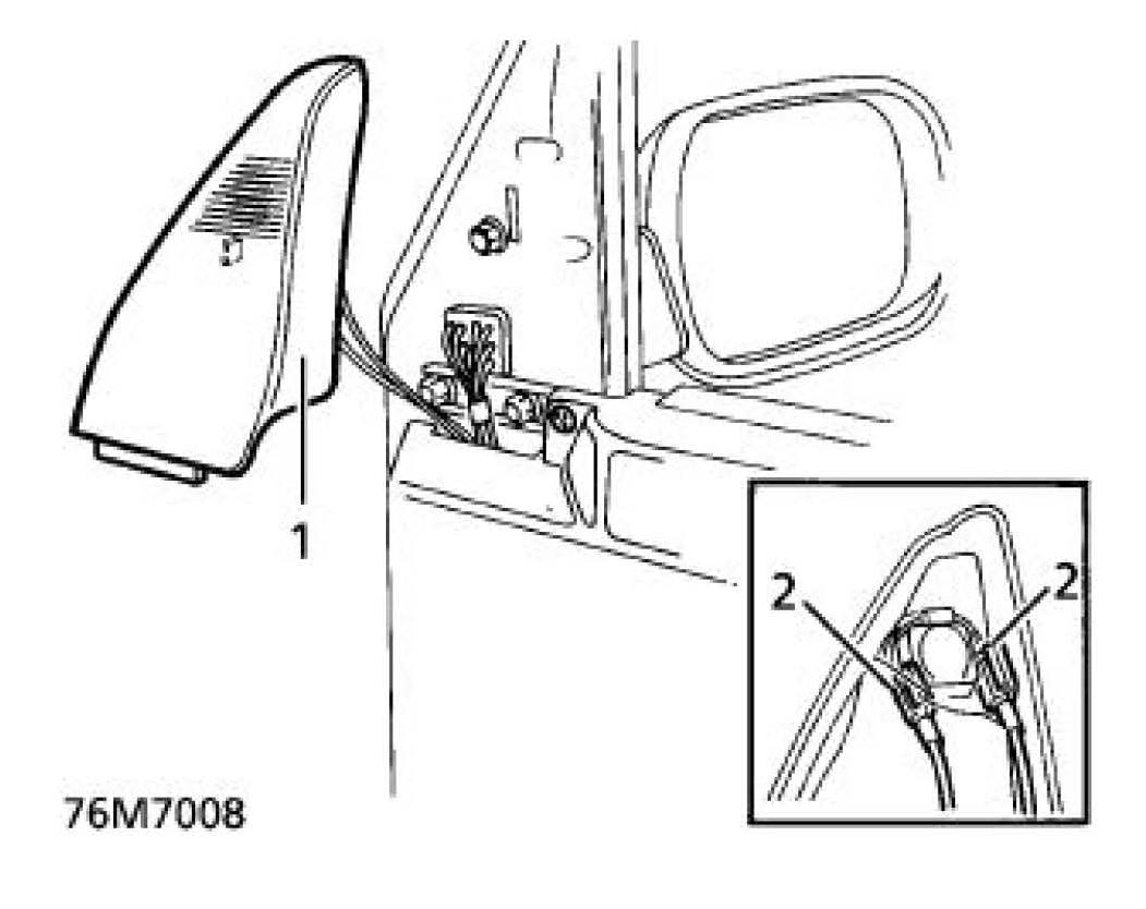

2. Disconnect 2 tweeter speaker connectors, remove cheater panel.

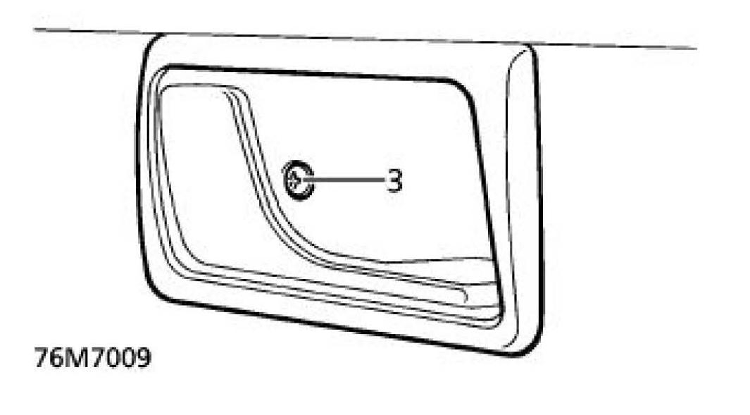

3. Remove screw securing remote handle escutcheon, remove escutcheon.
pic 5

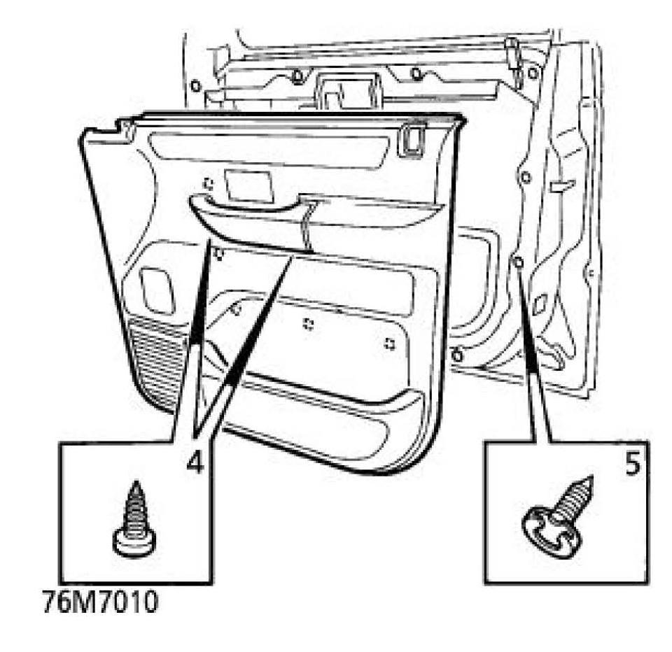

4. Remove 3 screws securing trim casing.
5. Release 12 clips retaining trim casing.

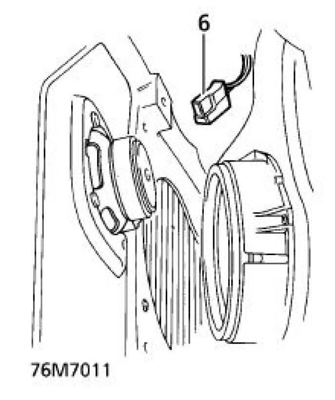

pic 6
6. Disconnect speaker connector.
pic 7
7. Remove door trim casing.

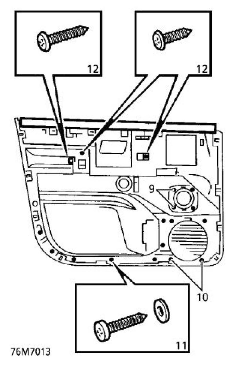

8. Remove 12 trim casing retaining clips.
9. Remove 4 screws, remove speaker.
pic 8
10. Remove 4 screws, remove speaker grille.
11. Remove 7 screws, remove trim casing pocket.
12. Remove 3 screws, remove arm rest.
