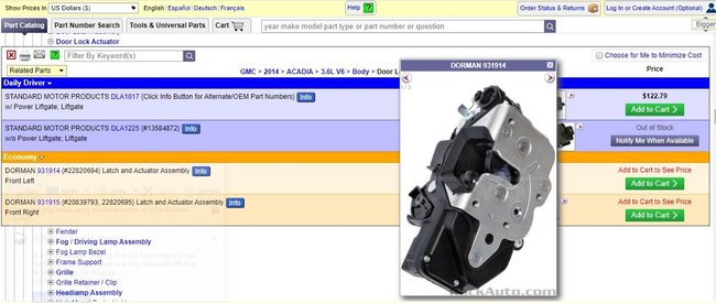

Hello, I have a problem with my door locks not working properly. My local mechanic told me the door actuators need replaced. I want to buy them and just have them installed, but I'm not sure how many are in the SUV? My front drivers side door works properly, but the front passenger and both rear doors do not lock/unlock electronically by either the fob or the interior button.
My question, are there 2 or 4 door actuators in my vehicle?

There is one per door. You have 4 actuators.
Rock auto has them. I attached a picture.

Roy, thanks for the reply. I saw this listed in RockAuto as well, but they both say Front Left and Front Right. I don't see any for the rear doors. Am I missing something?

I believe the left front and left rear are the same. I see the liftgate is listed as well.
Call them to confirm. I believe the left and right will work on both the front and rear.
