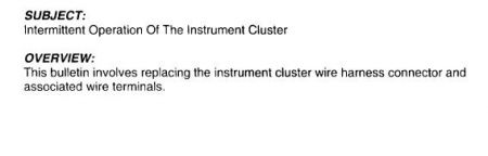

Engine Performance problem
1999 Dodge Van V8 Two Wheel Drive Automatic
digital odmeter reads no bus ,alll gauges go dead wont start let sit fires up

Welcome to the forum, I saw a service bulletin about a similiar problem. I can't be positive that is your problem? Check trouble codes, if they relate to, ( no cluster ccd bus) perform the procedure, so says the bulletin, 08-05-00
https://images.2carpros.com/forum/automotive_pictures/170934_dodge_van_instrument_cluster_1.jpg
