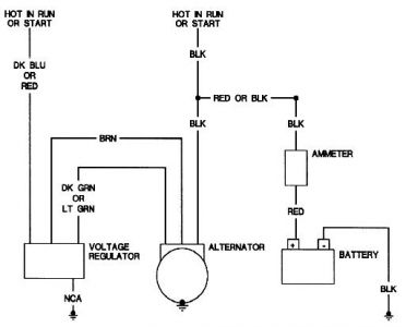

Im looking for a wiring diagram for the charging system. Namely the alternator with an external regulator.

This what you need?
