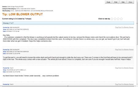

The air Deverter for the Ac/Heater has broken. This is the piece that switch incoming air from Fresh to cabin air. The piece I was required to purchase was the whole housing for the deverter. How does the vent system come out so that I can replace this unit?

this seems to be a common problem. ther eis a video on you tube showing how the guy fixed it. he took ot blower and threw the door away. anyhow here is one thati took off of tips in mitchell's as mitchells tells you to pull the dash. do as you like.\
https://images.2carpros.com/forum/automotive_pictures/406719_dodge_recirc_door_1.jpg
