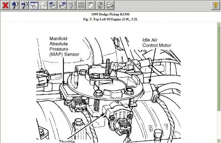

where is the map sensor located?

Manifold Absolute Pressure Sensor (3.9L)On front of throttle body Check out the diagrams (Below). Please let us know if you need anything else to get the problem fixed.

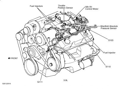

Where is the map sensor located on the 5.9L engine?

The map sensor is near the top of the engine. Check out the diagrams (Below). Please let us know if you need anything else to get the problem fixed.
