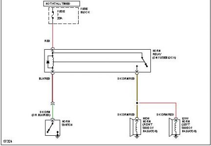

1986 Dodge Truck blow fuse
1986 DODGE TRUCK
TERRY KS47
Electrical problem
1986 Dodge Truck V8 Two Wheel Drive Automatic
keep blowing horn fuse

Welcome to the forum, does the fuse blow as soon as you plug it in, or only when you try to honk? You can unplug horn relay in fusebox, unplug relay, use jumper wire on switch side of relay, see if horn will honk without blowing the fuse? You see the arm on the right side of relay, when the relay is energized, that arm swings to the dark green wire with red tracer.
