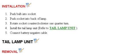

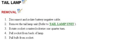

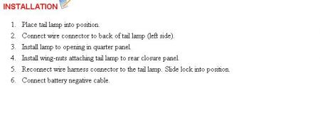

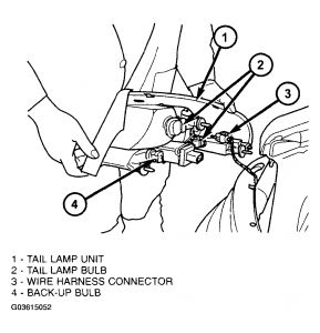

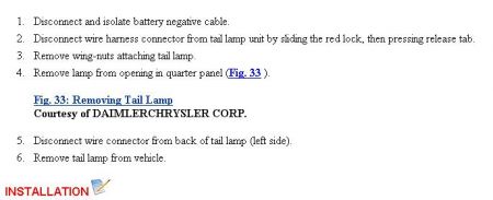

Need to replace break light bulb how does it come out?

ZACKMAN
MECHANIC
4,202 POSTS
Tuesday, February 24th, 2009 AT 10:22 PM
