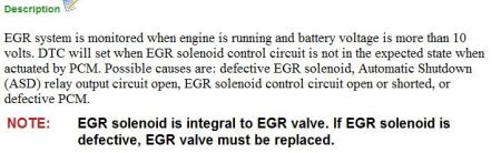

I am pulling a code up and it is p0403 and it is sating exhaust gas recirculation circuit malfunction, what is this and what do I need to fix this and how much will it cost me? Please can any one help me out. THANK YOU CHET

https://www.2carpros.com/forum/automotive_pictures/55316_01stratusp0403_1.jpg
For price on EGR valve, call your local parts store directly. Price varies by localities. If you need a shop to do, they will charge you 1.2 hours diagnostic, and 1.3 hours remove and install.
