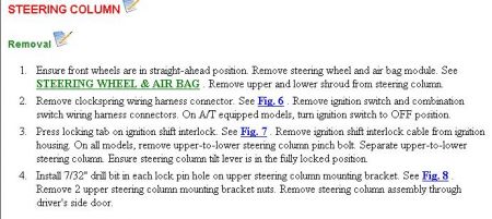

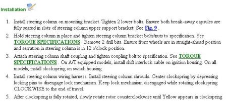

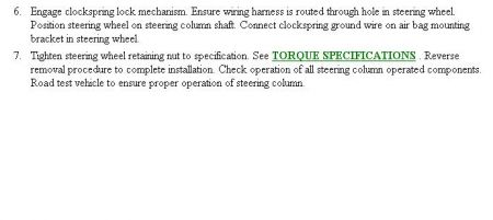

WHO TO CHANGE STEERING COLUMN?
Monday, January 26th, 2009 AT 1:26 PM
ZACKMAN
MECHANIC
4,202 POSTS

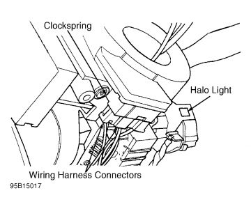

Figure 6

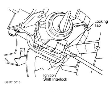

Figure 7

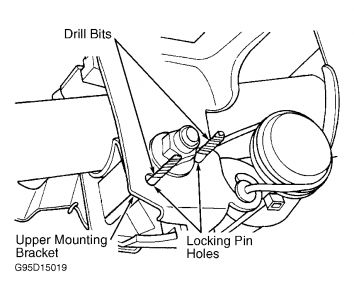

Figure 8

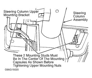

Figure 9
