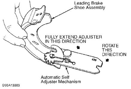

I am trying to replace the rear brake shoes on my car, I am having trouble with the brake self adjusting actuator. I do not know how it fits and I need some serious help and illustrations would help if you got them to spare!

Here is a video to show you how to do the job its on a different car but the job is super similar: https://youtu.be/1j7qDoi1LP0 and https://www.2carpros.com/articles/how-to-replace-rear-brake-shoes-and-drums
https://images.2carpros.com/forum/automotive_pictures/30961_shoe_1.jpg
Check out the diagrams (below). Please let us know if you need anything else to get the problem fixed. Cheers
