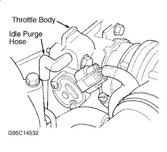

Thanks so much for the information you have given me. I have just have one more question; "what is the throttle body, ' "and where is it located?
Tuesday, March 9th, 2010 AT 4:50 PM
BMRFIXIT
  • 19,053 POSTS
This is on a V6
where air enter the engine
https://www.2carpros.com/forum/automotive_pictures/99387_Graphic1_675.jpg
