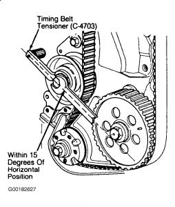

How do you tighten the timing belt with the tension idler?

Need tool without use wrench position at 9 o'clock then raise wrench up 15 degress, tighten
