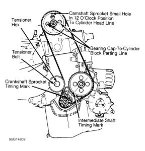

1993 Dodge Spirit 4 cyl Front Wheel Drive Automatic
looking for timing diagram not sure how to allign timing marks if they point up or towards each other or away from each other

find all you need at this link https://www.2carpros.com/car_repair_information/tec_info/1993/dodge/spirit/1993_dodge_spirit_timing_belt_diagram_marks.htm
https://images.2carpros.com/forum/automotive_pictures/99387_Graphic1_203.jpg
