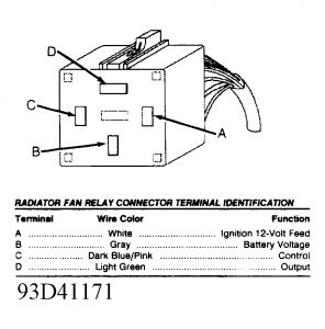

First let me go over the fan relay wiring so you can test that. White wire (a) 12 volts ingnition on. Gray wire (b) battery voltage. Dk blue/pink wire (c) control. Light green wire (d) output.
https://www.2carpros.com/forum/automotive_pictures/249564_Graphic_23.jpg
