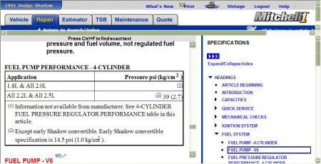

1991 Dodge Shadow fuel pump pressure
1991 DODGE SHADOW
SMOKESTACK48
Engine Performance problem
1991 Dodge Shadow 4 cyl Front Wheel Drive Automatic
On an early model 11/90 is the pressure 14.5 on a convertible,or should it be the same as the later model 39#?
