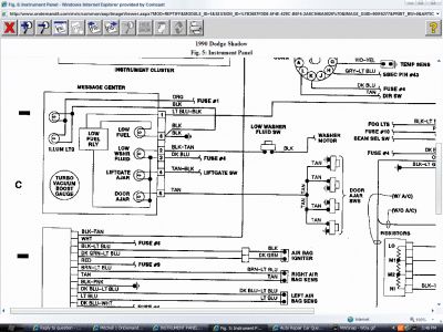

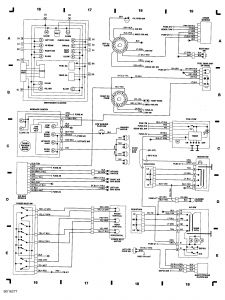

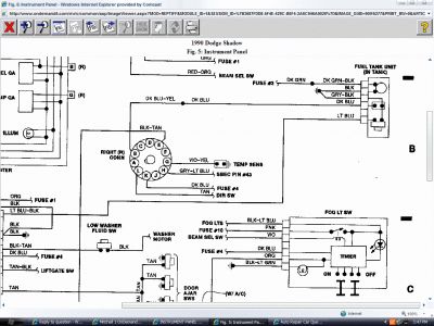

The pump should get power for 2 seconds or thereabout, with key in on position, if not check the relay, here's a wiring diagram to help trace any shots, and locate the grounds.

A short addendum to my problem. I checked the ASD relay for power. Like the fuse and the pump connector, the relay has power ONLY when the key is turned to START. The relay does not turn on when the key is turned to ON.
How do I read the wiring diagrams you sent? The print is too small for me to read.

Bought the wiring diagrams. I noticed that the ASD relay has a fusible link on it. Would that stop the relay from energizing? Pin 30 has battery power to it with the key in the OFF position.

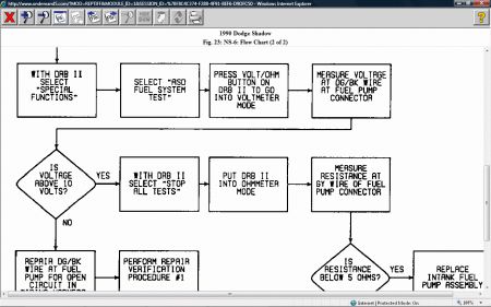

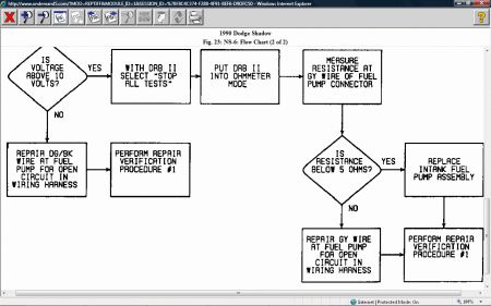

Lets get under the car and unplug the fuel pump connector, test with a DVOM as shown.
https://www.2carpros.com/forum/automotive_pictures/62217_Shadowa_1.jpg
https://www.2carpros.com/forum/automotive_pictures/62217_Shadowbgif_1.jpg
And yes if the fuse links at the ASD is blown the ASD will not power up!
Tuesday, August 12th, 2008 AT 6:25 PM
LANDRUS
  • 16 POSTS
I don't wish to sound unappreciative regarding the help you've offered so far. Without even crawling under the car I can tell you that with the key in the ON position there are 0 volts at the pump conncetor. The fuse and ASD relay also have 0 volts when the key is in the ON position. The pump connector, fuse, and ASD relay all have 12 volts when the key is turned to the START position. I know believe the issue lies either in a fusible link or the ignition switch but I'm not sure how to test either.
