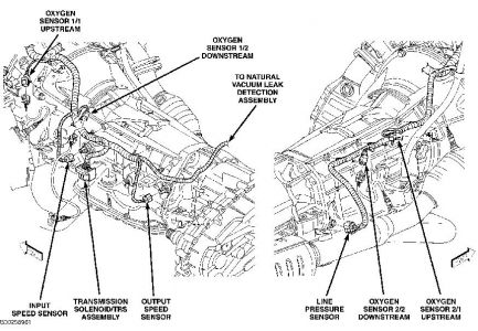

How many O2 sensors does an 04 Dodge Ram 1500 4x4 have and where are they located?

Hey russ what engine?

It's a regular 4.7L V8.

I thought the diagram would help better , there are for , two on each side , 2 upstream and 2 downstream
