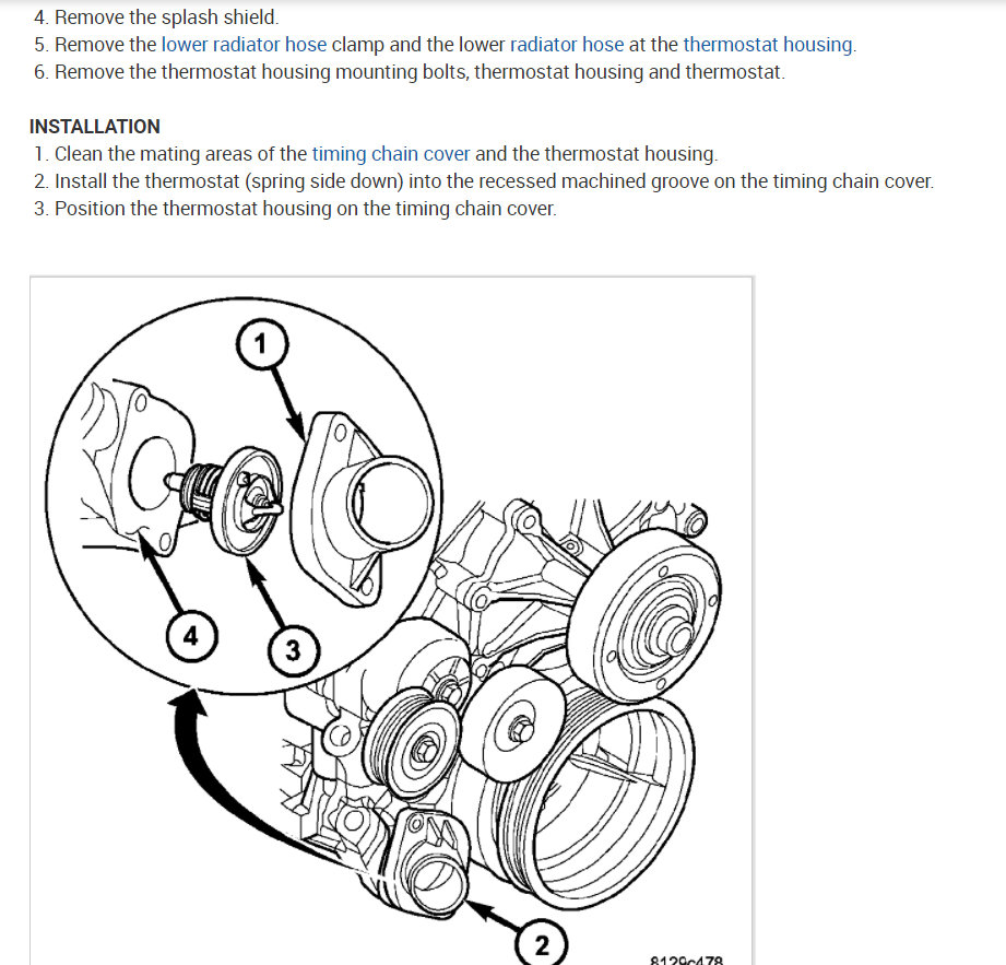

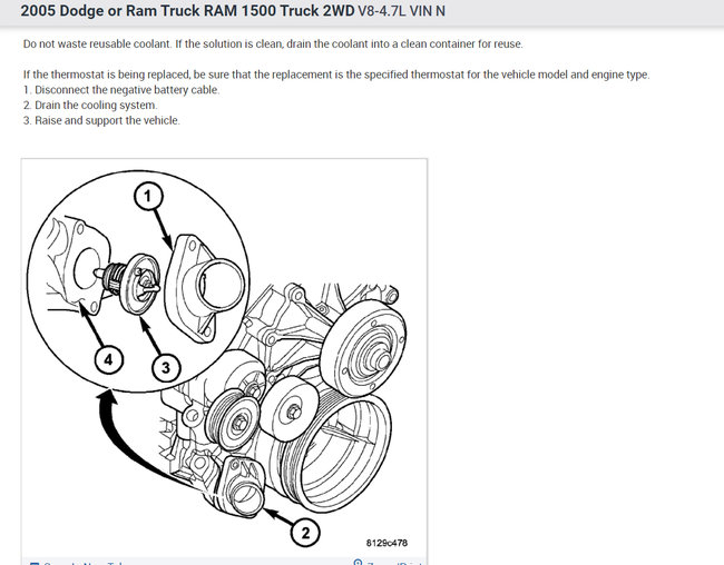

Where is the thermostat?
2005 DODGE RAM
20,000 MILES • 6 CYL • 2WD • AUTOMATIC
OLGALEPCC
Oct 14, 2008 at 11:53 AM
TEAG
  • 158 POSTS

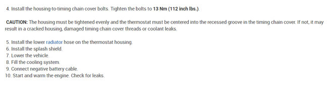

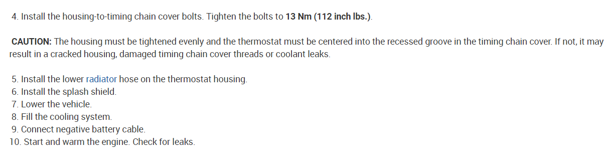

You should be able to find it by following the bottom radiator hose back towards the water pump. The thermostat is located inside the housing at the end of the hose. Here is a guide to help you step by step with instructions in the diagrams below to show you how on your car.
May 13, 2021 at 12:06 PM
