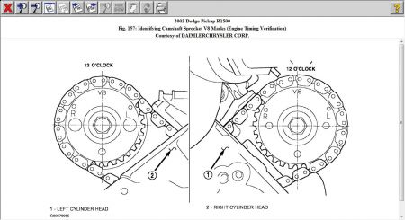

Dodge ram 4.7l My friend thought cat. Converter was plugged so he punched a hole in it. I removed it to inspect it its in great shape.I checked spark plugs most where fouled so I R&R them. Before I did it ran like it was only firing on 4 cyl.S now it won't start at all I gapped the plugs to spec. And checked fuel pressure 47- 57psi while cranking. I checked for spark to each plug that was good. Im trying to read the ecm for codes but it says there are none. I tried to spray eather in the intake just to see if I could get it to pop or try to start but nothing.

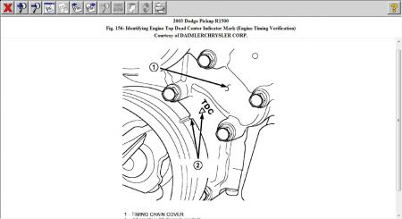

Checking valve timing-remove sparkplug no. 1 stick a compresion gauge in it or use your finger to feel for compression while you crank engine over in burst stop when you feel the pressure and manually turn the crankshaft to line the markings on the crank pulley and the timing indicator to TDC/0, now open up the distributor cap the rotor should be pointing at the no.1 cap tower if not the valve timing is off, also both no.1 valves should be closed

This motor has a Direct Spark Ignition system. I looked just to be sure but no distributor. Lol just had to check. I thought may Crank/Cam sensor but thay would not let me have spark, right. I used a test light to test the fuel injector leads and I have pulse. Not really sure of a way to see the spray pattern to check if their clean. I used my bore scope to look in the cylinders to look for damage. None. Oh and no codes but mil light still on and after cranking for 8-10sec. It starts flashing, still no code. Ok I checked the compression on the cylinders they range between 118-135psi. I also found a little antifreeze on the pass. Side front plug? Its at 130 psi. Truned crank to TDS mark and the cams align like the picture. It kinda pops a little if I crank it for 10 sec or so. Hmmmm I running out of ideas. Now can I have spark and fuel if the crank/cam sensor was bad? Wouldn't it throw a code?

I have the vavle covers off and see the cam alignment points the #1 cyl valves a closed. The first cam lobe faces pass. Side and second lobe faces driverside both just slightly down is there any way to adjust timing on DSI systems?
