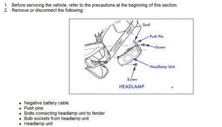

The covers on my head lights are getting nasty inside. How do I remove the head light? I can't find a way to remove it.

The lamp assembly itself may not come apart? I found this removal procedure.
