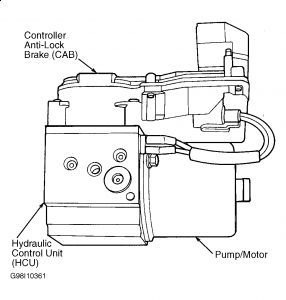

When you say ABS kicks in does brake pedal pulsate?
Codes indicate fault in CAB/HCU
+2
Saturday, February 27th, 2021 AT 11:24 AM
JKLAIBER
Yes, the ABS comes on but not until your just about ready to stop. If I brake normally it won't come on till the last 0-5mph. Sometimes if I brake slowly enough it won't do it.
The person I bought if from had replaced the brakes but not the rotors, and he had removed the ABS fuse because of this problem. I have since replaced all four rotors and replaced the fuse. No ABS lights or Brake lights come on.
What does CAB/HCU stand for?
DOCFIXIT
  • 18,828 POSTS
ABS pump and controller
https://www.2carpros.com/forum/automotive_pictures/198357_Graphic_3.jpg
