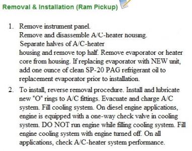

I was looking for directions for removal and replaceing AC evaporarator. Any help out there?

Thank You
