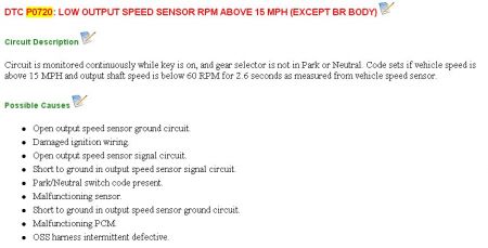

I need to change the shaft speed sensor for 1999 dodge ram, It won't shift, the code came up P0720.

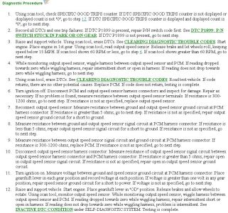

Do you want the diagnostic procedure first?
More coming.
Check your email shortly for larger images.

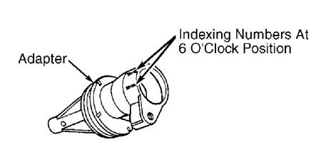

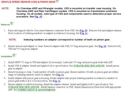

It is on the overdrive transmission case.
