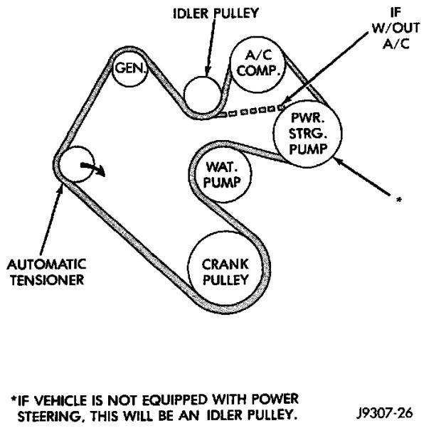

Can I bypass a locked-up AC compressor clutch by using a drive belt for 5.2L w/o AC? This belt will be shorter of course, the routing diagrams appear to be the same with the exclusion of the compressor.

Looks like you have one of the few vehicles that they put a little thought into teh drive belt routing. To answer your question, yes you just need a belt for your vehicle without A/C
See diagram below

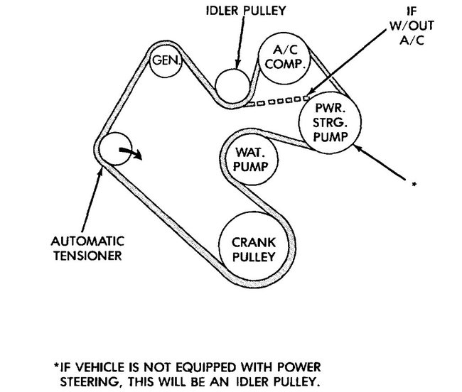

Serpentine belt routing for 2002 Dodge Ram 1500?

Here is a guide and a diagrams below to help you change the belt on install the new one.
Check out the diagrams (Below). Please let us know if you need anything else to get the problem fixed. Cheers

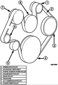

Need drive belt diagram

https://www.2carpros.com/forum/automotive_pictures/561653_Belt_diagram_04_1500_37_1.jpg

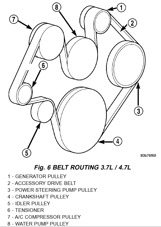

My 99 Dodge Ram 1500- 5.2L has a seized AC compressor. Can I re-route a shorter serpentine belt to bypass the seized part? If I can, do I need a new tensioner or can I adjust the old one?
If any of this is a possiblility, will I require any specialty tools?

Get a S/Belt w/o an AC

This may help you
