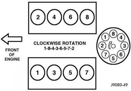

1997 DODGE RAM
Whats the diagram for the distributor cap and firing order and cylinder order
Monday, July 5th, 2010 AT 11:45 PM
MECHANIC
75,992 POSTS
Tuesday, July 6th, 2010 AT 3:55 AM
