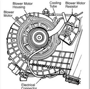

Where is heat resistor I only have hi and off

The resistor is located under the dash on the passenger side, right next to the blower motor. Just held in with 2 screws.

Hi, the blower resistor should be under the right side instrument panel.
