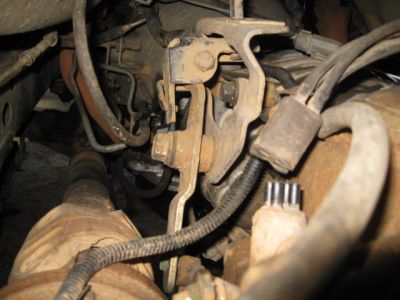

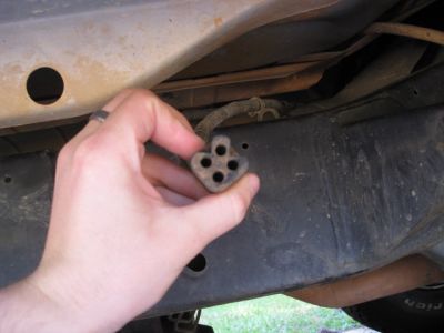

Oh... while I was down there, I found this 2-3 foot long stretch of cord (4ea 10 or 12 guage wire). Thing was unplugged and I don't know where the heck it goes but it was nearly dragging on the ground. It was hanging on the passenger side of the transmission.

What's on the other end of that plug, wires or vacuum hoses? Beginning with '96 models, every vehicle sold in the U.S. Had the On-Board Diagnostics version 2, (OBD2) emissions system. Besides having a lot more available trouble codes, it included a second oxygen sensor in the exhaust right after the catalytic converter to monitor its efficiency. V-type engines usually have two catalytic converters, and each one has an O2 sensor right before it and right after it for a total of four sensors. Removing the converter(s) should have caused the Check Engine light to turn on, but I also think I heard there is something made that can be plugged into the harness to trick the computer into thinking the converters are there and working. That would be illegal but that's beside the point.
That connector in the photo is the shape of an O2 sensor connector but it looks more like hard rubber. That could be a vacuum hose connector for the four-wheel-drive switch on top of the transfer case. Those switches gave some trouble if moisture got in there. The switches would stick and cause the 4wd light to stay off or on, I can't remember. It switches vacuum to the vacuum motor, (actuator), on the right side of the front axle to lock the two axle shafts together. When they are unlocked, it allows them to turn at different speeds when cornering without forcing the front driveshaft to turn. That reduces the force needed a little to improve fuel mileage. When rust develops in that switch, it either sticks in 4wd or 2wd. Can't remember which, but if you unscrew the switch from the top of the transfer case, you will see a round metal ball on the end and it will be full of rust.

"Mysterious wire/cord" = Vacuum system:
Yeah, definitely vacuum. I found where it is supposed to plug in (drivers side on the transfer case) Now I just have to figure out which way the dang thing is supposed to plug back in. It makes sense after the last time I had a bit of mud on the truck and could see my front wheels weren't turning (while the backs ones certainly were). Anywho, I went to go reattach the female end to the male end hoping it was one of those "dumbproof" connections, but the male housing isn't "keyed" like female side. It's just four male ends sticking up. I stuck it in the way in naturally bent for now (as pictured with the notched end pointing toward the front passenger side).
