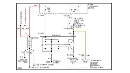

I had my truck for a while and the alternator light came on and a week later it died so I got a new alternator and a new battery and it turn on but the check engine light was on and the alternator light was on and then a hour later it turn off so I replaced the battery and alternator again and it happen again I dont know what could be the problem please help me its my only vehicle and everyone I talk to has no reason why its not turning on and this is my last chance

Sounds like the voltage regulator built into the computer is malfunctioning-
https://www.2carpros.com/forum/automotive_pictures/12900_regulator_5.jpg

Well dodge dealership said that the voltage regulator is built into the alternator so I dont know what else to do

Have the alternator retested this time tell them to full field the alternator doing this will cause the alternator to throw out everything its got.

I took the alternator in and they said its perfect that there has to me some other reason

Earlier I've given you a diagram of your charging system. Could be a problem with the computer (Powetrain Control Module ) control of the field generation of the alternator. Have it checked out-
