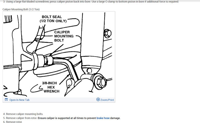

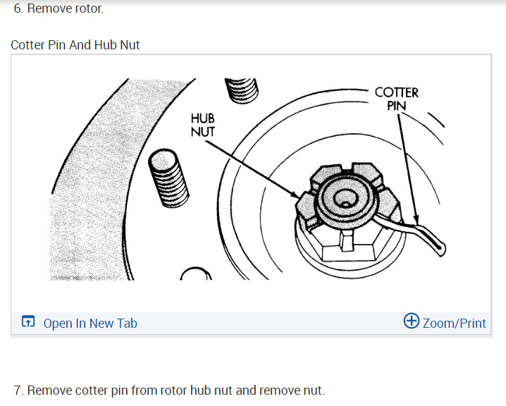

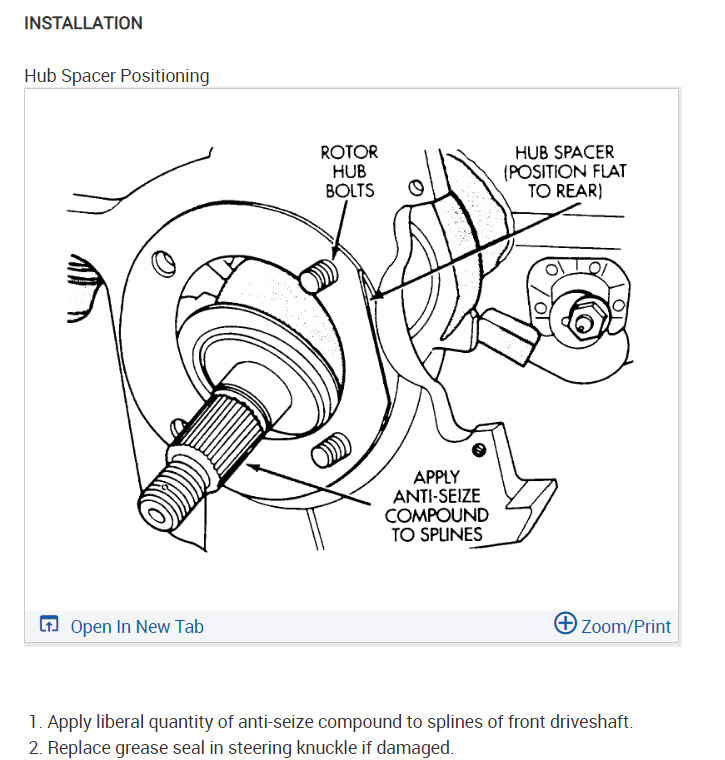

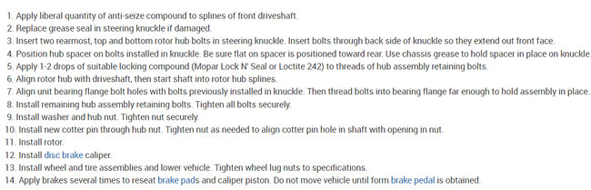

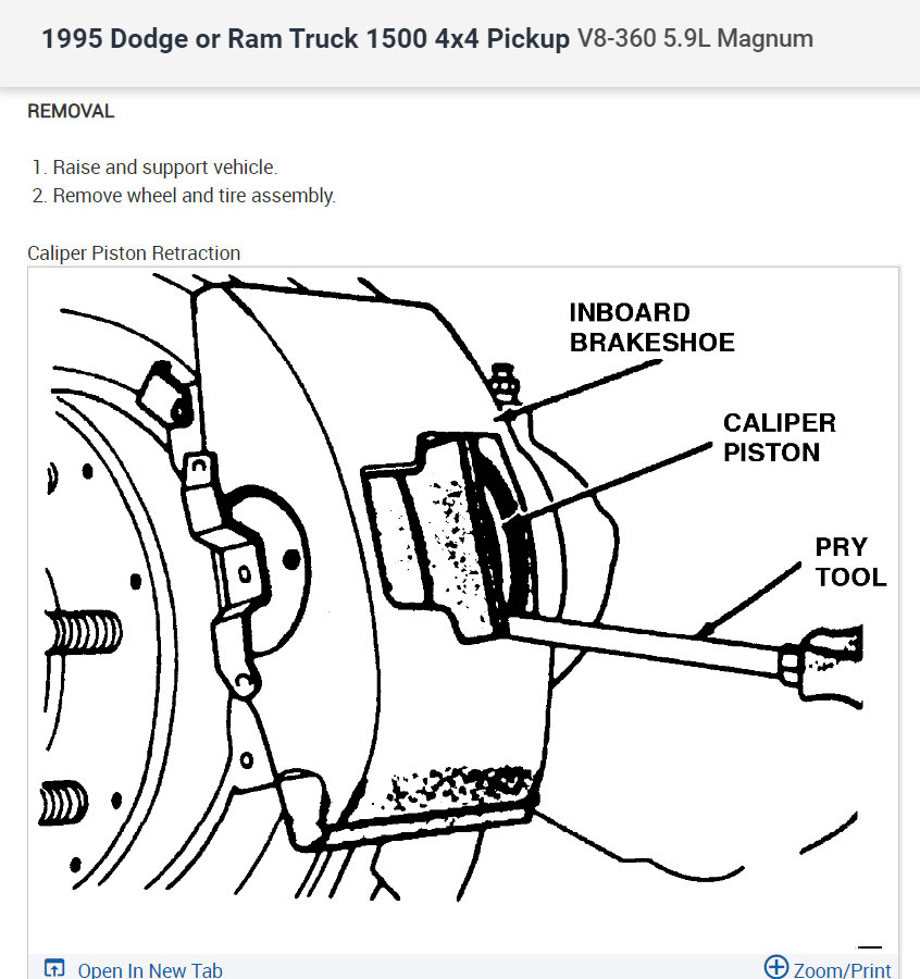

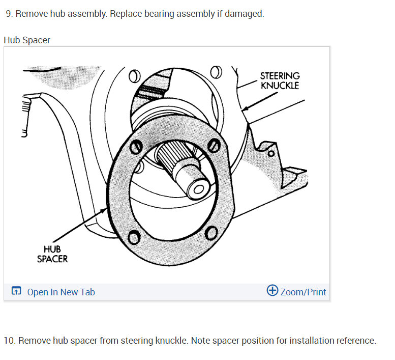

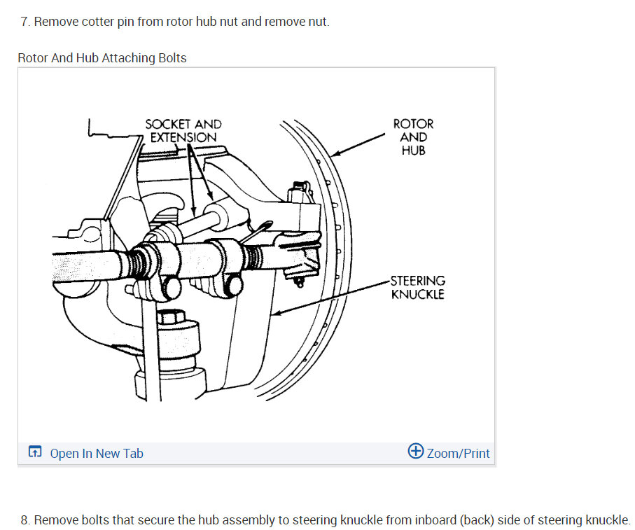

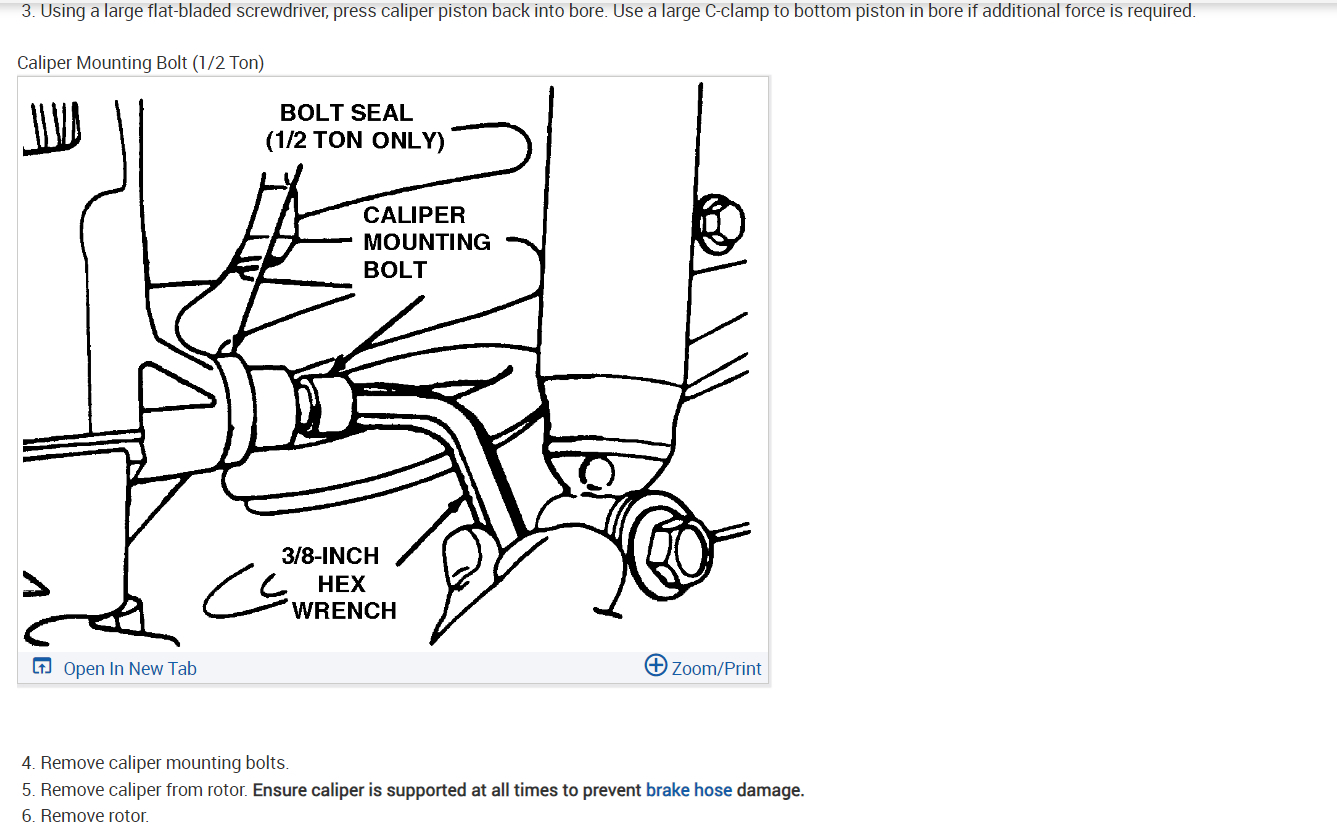

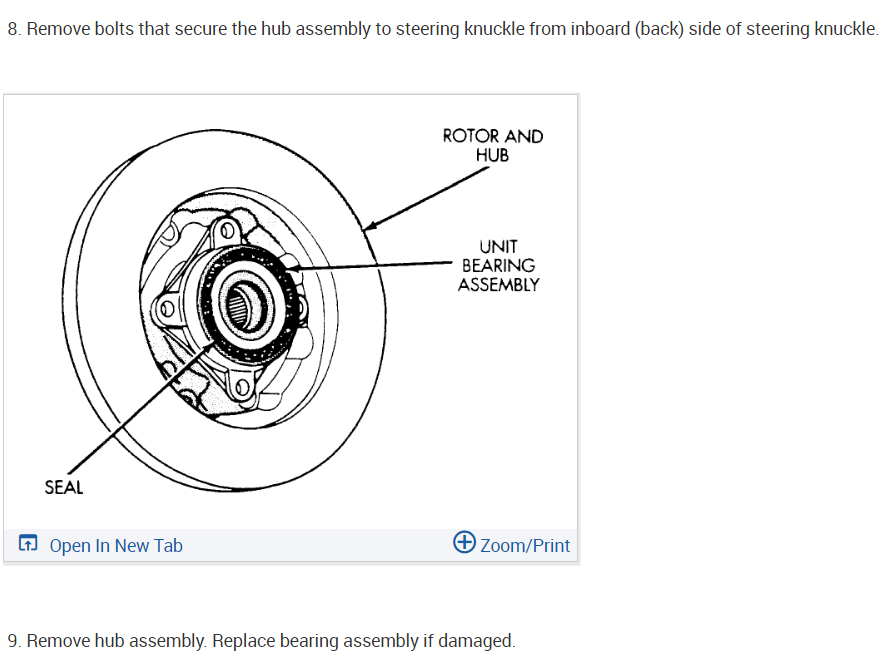

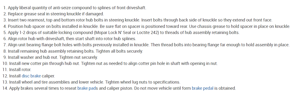

How do I remove brake rotors?
Sunday, December 9th, 2007 AT 10:59 AM
MERLIN2021
MECHANIC
17,250 POSTS
Here's the procedure, it looks like the rotor will come off with the bearing hub and then you can disassemble it. Check out the images (below). Let us know if you need anything else.
