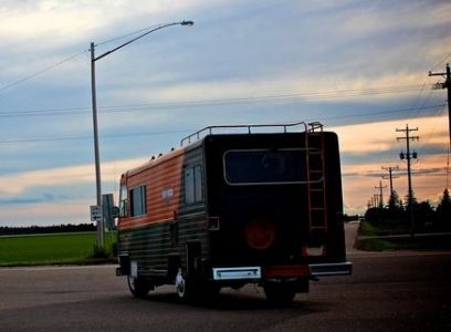

I have a 1975 winnebago with a dodge 440, we bought it for 1000$ about a month ago and it ran fine but one day it just died, now when we try and run it it either won't start or will idle for about 1min and then die and sometime if we get it to start we can give it gas and it will rev up but then eventually die and other times as soon as we hit the gas it will die, we changed the fuel filter and checked the fuel pump and they all work, we think it might be something with the carburator but would like to here your advice on what you think it might be before we start messing with the carb...
Thanks,
Ben
http://www.2carpros.com/forum/automotive_pictures/559050_bago_1.jpg
