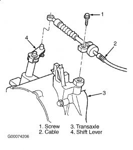

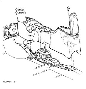

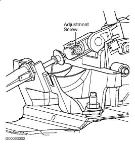

My dodge neon would be parked, and I would insert the key, turn the key, ALL LIGHTS come on, turn the key but silence follows.
I have to literatelly HIT THE SHIFT in PARK and then the car can be started without any problems.
any ideas?

Shifter link out of adjustment
check and adjust shifter cable
