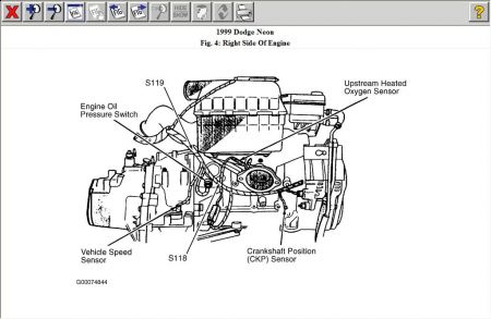

Hi malibu1320, Welcome to 2carpros and TY for the donation
The fuel pump is in the fuel tank
You might want to inspect and test the vehicle speed sensor located in the transmission extension housing.

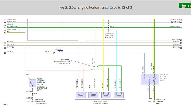

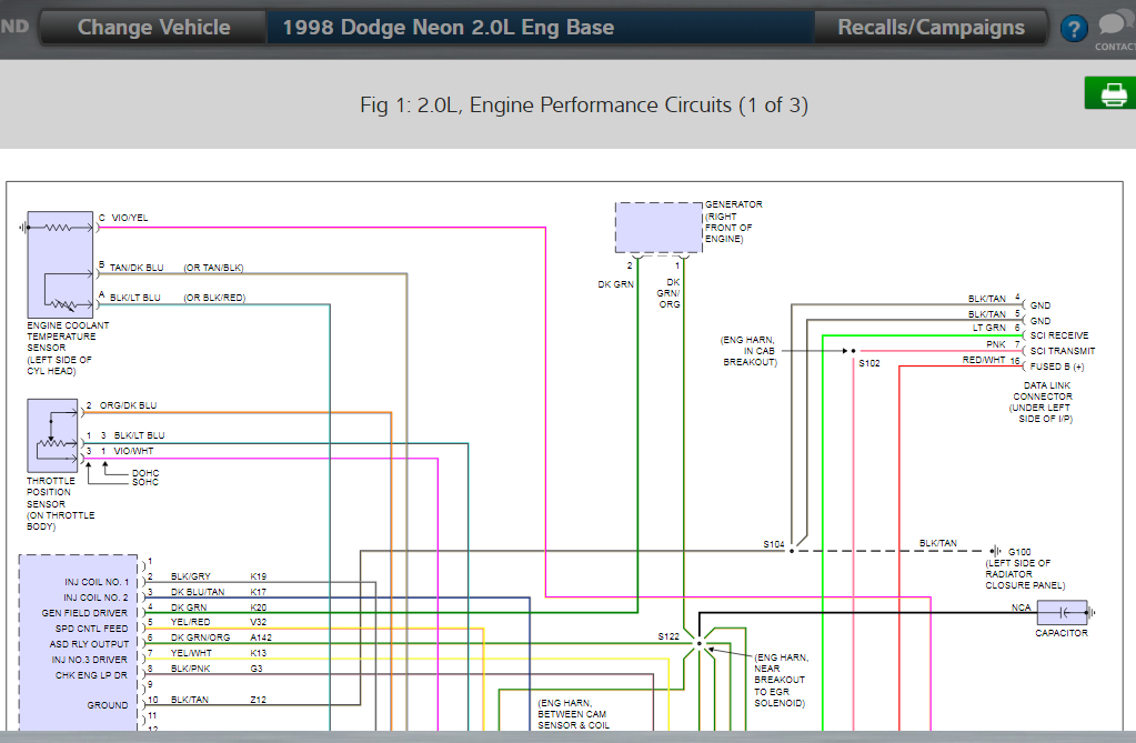

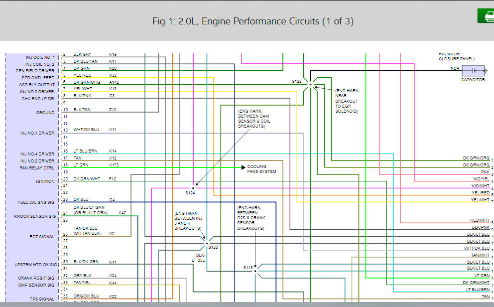

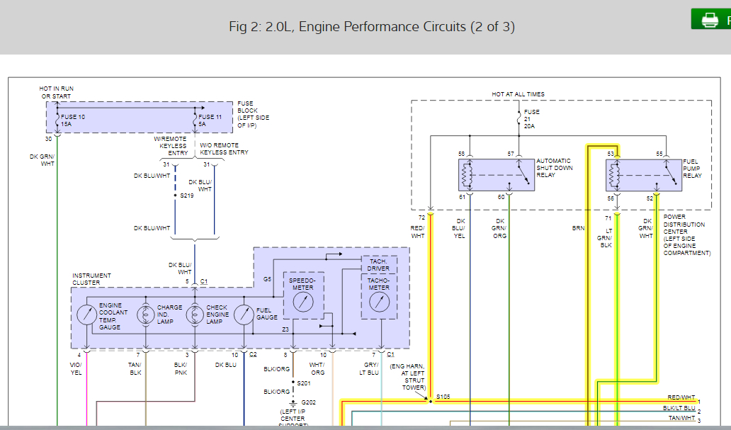

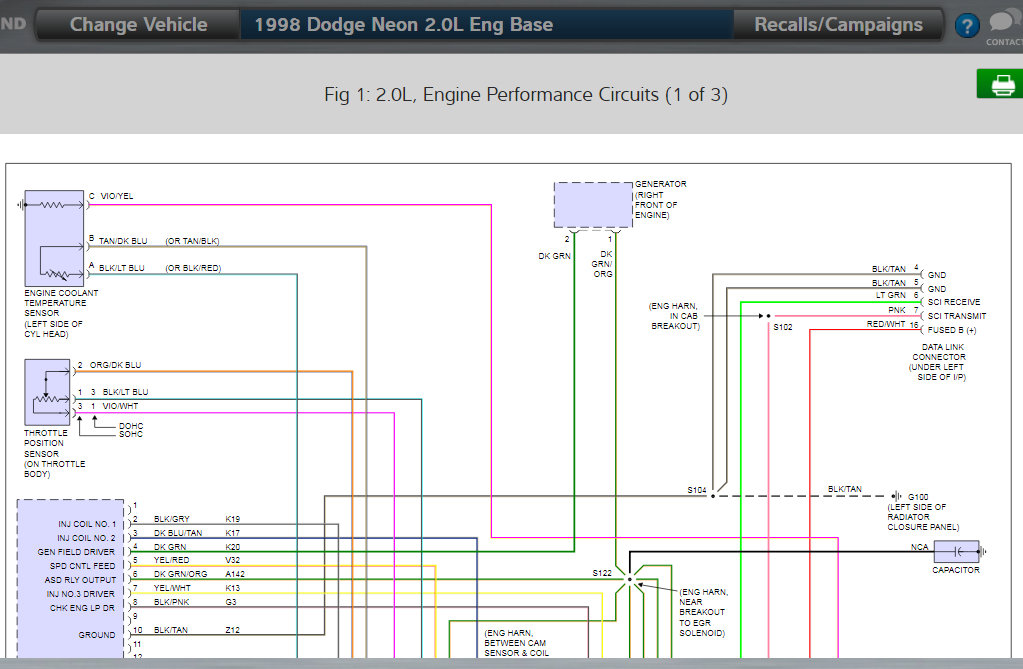

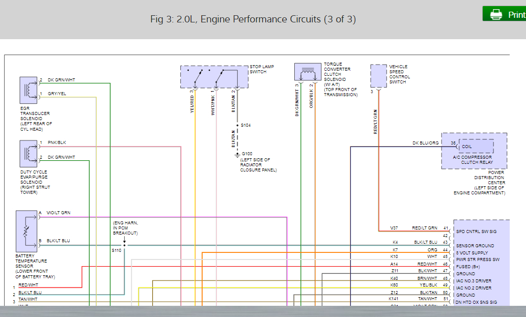

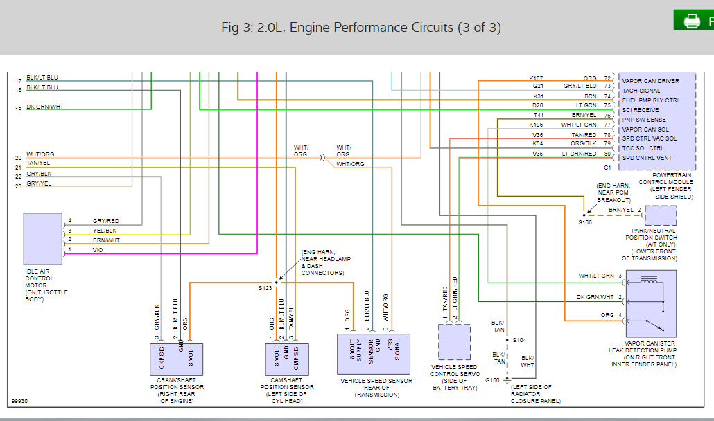

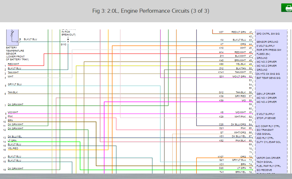

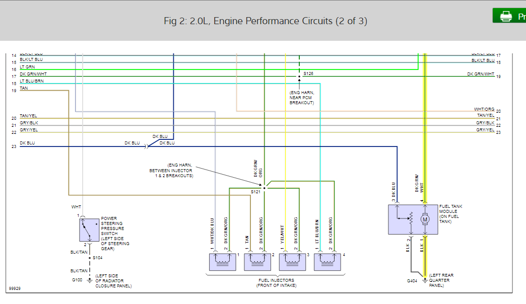

SCGRANTURISMO
  • 4,897 POSTS
The problem here is probably a short to ground in the fuel pump circuit. A short to ground will blow the fuse protecting the circuit because of laws governing electricity, Ohm's Law. Electricity can be broken down into three components, Voltage (Electrical pressure), Current/Amps (Electrical flow), and Resistance (Anything that opposes electrical flow). Ohm's law states that if one of the three components is constant (one always is in automotive electrical Voltage (12VDC) and another goes up (Amps) than the last one must go down (Resistance). This is a short to ground because the voltage is not making it to the load (fuel pump) because you have a bare wire somewhere touching ground. With no resistance the Amps (Electrical Flow) will go up until it overtakes the (20A) fuse and "pop" the fuse blows, just like it is designed to. Find the damaged wire in the circuit and repair it and you have fixed the problem.
I have included wiring diagrams for you in the diagrams down below with the fuel pump wires highlighted. Please find the short and get back to us with what you find out.

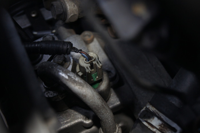

Does this look like it could be the problem? My husband said there is what looks like a wire harness that looks exposed on one end. Does that help?
Thursday, December 17th, 2020 AT 8:34 AM (Merged)
CARADIODOC
  • 34,491 POSTS
That appears to be the pressure switch on the back of the AC compressor. That is in a different circuit than the fuel pump.

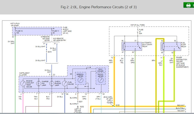

JDL
  • 16,098 POSTS
Did you check for any applicable trouble codes? Did you check for voltage and ground at the pump connector for the motor? The dark green wire with white tracer is voltage for the pump motor, check with engine cranking. Black wire is ground. Also, do you have spark at the plugs? Injector pulse?
https://www.2carpros.com/forum/automotive_pictures/170934_neon_fuel_pump_1.jpg
Thursday, December 17th, 2020 AT 8:35 AM (Merged)
PRHANSON27
We checked the voltage. There is no power going to it. The oil pressure switch appears to be fine as well. Its not getting any fuel into the injectors.

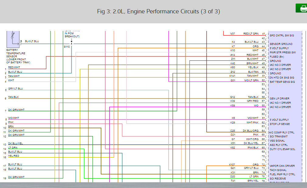

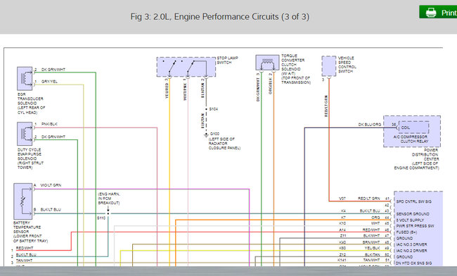

JDL
  • 16,098 POSTS
The voltage for the pump motor comes from the fuel pump relay in the power distribution center, under the hood. The computer may not be grounding the relay for some reason, that is why I asked you to check for applicable trouble codes. That is also why I asked you to visually check for spark at the plugs and injector pulse, engine cranking.
You can check for applicable mil codes, yourself. You cycle the key, no crank. Cycle the key on--off, on--off, on, then the mil starts flashing, you count the flashes to get the codes. Your looking for two digit codes.
At the pump relay diagram, terminal 55 is hot all the time. Terminal 56 is voltage for the coil side of relay, goes hot with the key in the crank position. Terminal 53 is ground for the coil side of relay, controlled by the pcm. When the relay is energized that line with the arrowhead switches to terminal 52, that terminal carries voltage to the fuel pump.
https://www.2carpros.com/forum/automotive_pictures/170934_neon_fuel_pump_circuit_1.jpg
