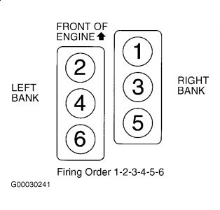

Where is the number 2 fuel injector circuit located and I need the firing order
Sunday, April 5th, 2009 AT 12:09 AM
